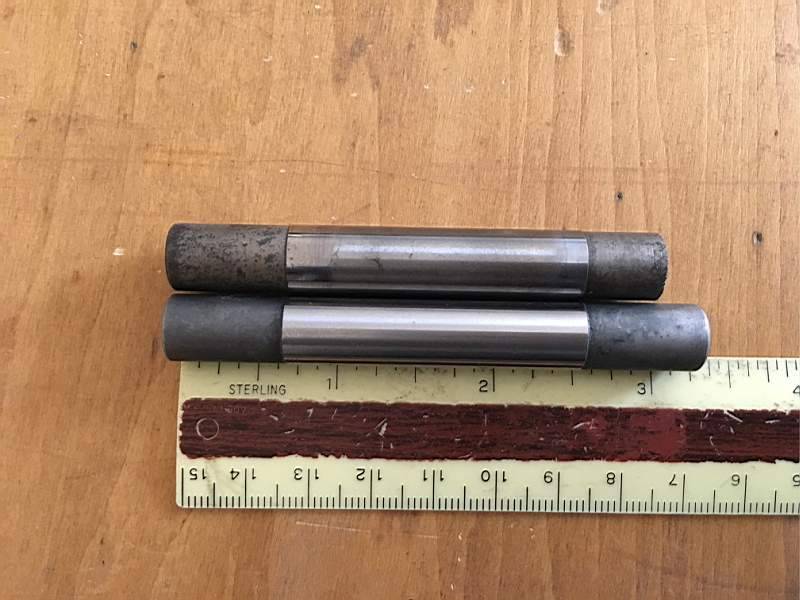

      Check your fuel pump push rod, I had this problem on a new engine. Original rod was not compatible with the new cam and got worn down. Replaced it with a Comp Cam push rod and haven't had problems.
      Alan

        The worn down push rod will cause vapor lock symptoms as well as running hot. It was driving me nuts as to why my car was running hot even when it was not hot outside.

          I finally got a chance to work on my car. I pulled the fuel pump and the pushrod looks worn down. I ordered another one.
          • Thanks! Thanks! x 1
