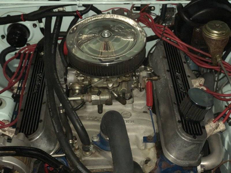

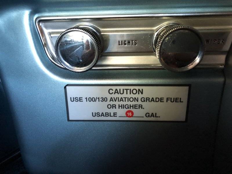

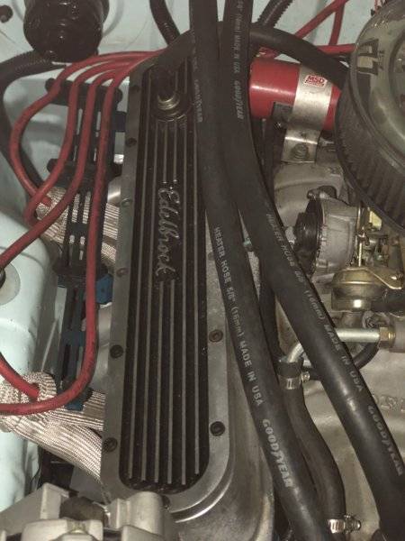

A couple more questions: 1) can anyone tell me where to put oil in this motor? The breather element does not twist off it just spins 2) what’s with the sign? I fill it it up with premium and a full can of octane booster. Is that good enough?

BTW I got the breather element off by pulling it to the side and it popped off. Had to put lot of pressure on it but it was the answer.
