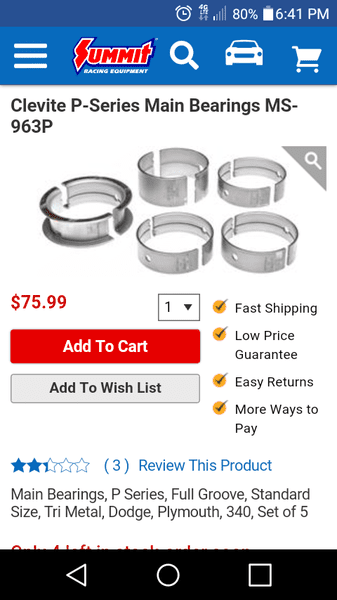

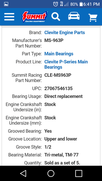

Those aren't full groove nor are they the race bearings.

In 1979 they might have been but they've been superceded by a new generation, Clevite uses the H designation for example.
I will enlighten u when I have my book in my possesion these are Clevite 77
That name or patented abbreviation was used for several bearing manufacturers content://media/external/file/207596s-
I understand they are Clevite. The P series is a mid-level bearing, the H is the race bearing. There's nothing wrong with P series, but like anything else.....hard to ignore the H series when you know it's there.
I think H series is a Nascar bearing if my memory serves me correctly.
