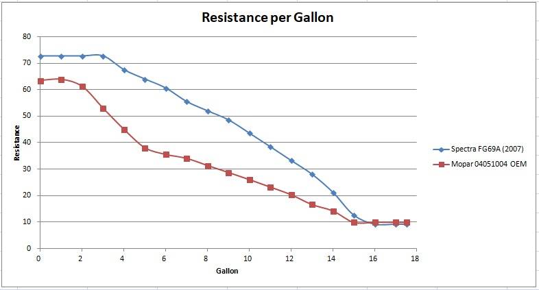

Look for threads about Meter Match. I fixed my aftermarket sender with one. Works well & reasonably priced.

I copied these out of other threads & used them to calibrate my aftermarket sender with a meter match. Did not do them myself.
