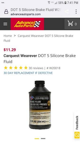

New parts, then install Silicone Brake Fluid In the complete system.
Silicone Brake Fluid does not draw moisture and create corrosion like conventional brake fluids do.
Especially good for vehicles that sit for long periods of time.
Especially good for the multiple piston calipers like Kelsey Hayes and the Corvettes. Keeps them from seizing up from non use and corrosion.
The DOT5 fluid is a good choice if you don't want the paint hurt. That's DOT5, not DOT5.1. They're different.
Also, it's not good to mix DOT5 with DOT4 or DOT3 as the seals will swell and become useless. So that means you either have to flush the HECK out of the system, OR you could replace all the rubber parts. Kinda a pain if the system is already together.
