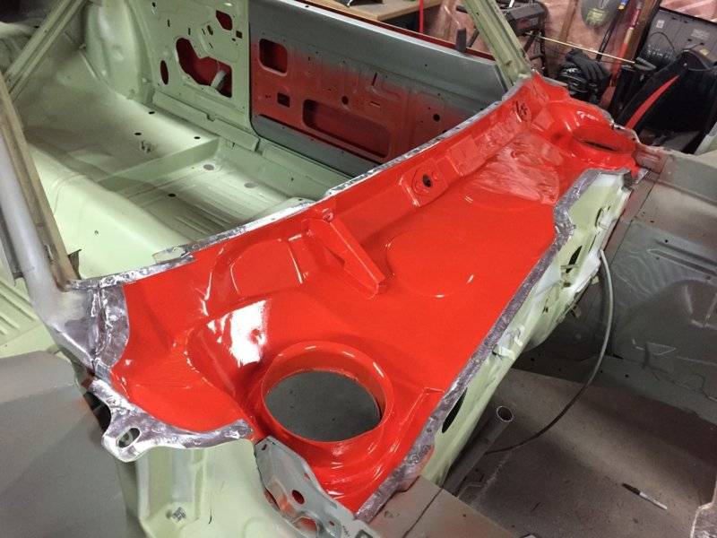

Photo I found on the 'net shows the cowl vent holes

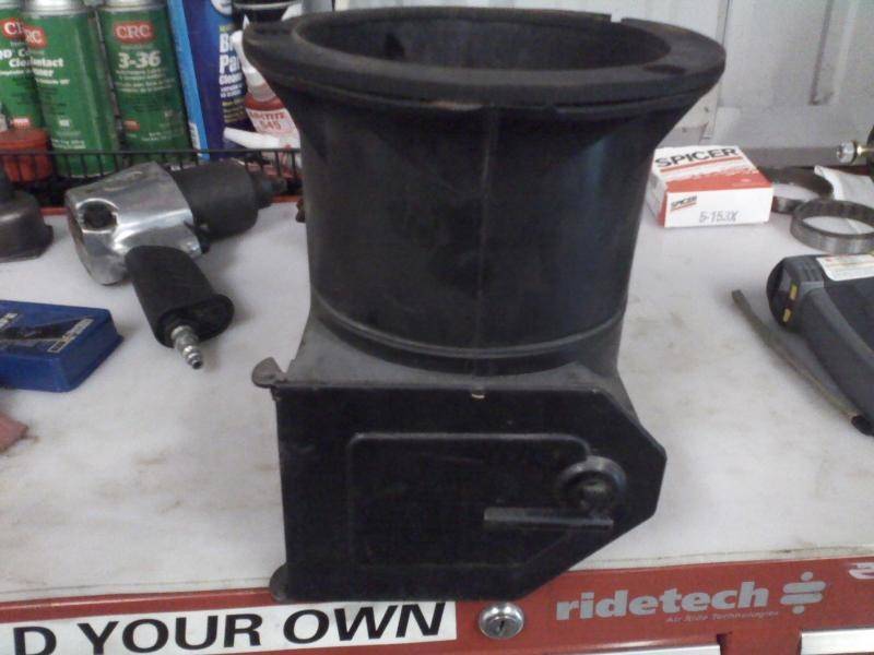

Driver side vent box if yours is missing

That drivers side piece is completely missing!

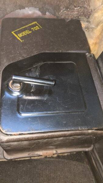

You were asking about the vents in the car.
Driver's side
Pass side
