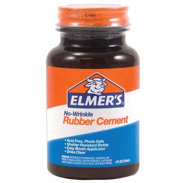

Could it have been plain 'ol rubber cement? Stuff is awesome but never tried it on clear plastic lenses
