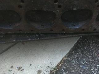

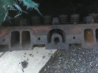

So a few weeks ago I purchased a 1973 440 block and 727 for 400 dollars. After looking for months, found it at a neighbors house that backs up to my house. He also has high performance heads for 50 dollars. I bought those as well. Ran numbers and they are 64 stage III Max Wedge heads. I want to use these but don’t know what else is needed...please help
Those are possibly not Stage III heads Max Wedge heads. "516" are a mid 60's, closed chamber run of the mill heads found on 361's, 383', maybe 413's and possibly some 66-67 440's. They have 2.08 intake and 1.60" valves. There are better stock B/RB heads but it depends on what your doing with the 440.
"518" Stage III Max Wedge heads are a whole other deal. Got a picture of the ports and the whole head?
First thing you would need would be a max wedge port intake manifold. The max wedge heads have taller Intake ports.
looks like 518 on the casting number to me
If you got all the parts for those heads. Personally I would have them checked to make sure they're good, insert bigger exhaust valves in them (1.60 to 1.74?) and run them.
MW stage lll should have 2.08 in. and 1.88 exh. valves if in stock form.
Looking at other 518 heads the part number is cast on the combustion chamber side of the head and not on the rocker side. But Ma did some things different from time to time.
The more I look at that pic the more I think dano
is right. If we could see if they have a heat crossover passage then we would know they are 516 heads.
Just a run of the mill closed chamber head.
