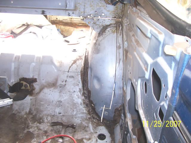

Well, i have been working on my 67 dart alot lately, besides going to the mopar nationals. I got one side of my mini tubb welded in , all i have left is a little filler to make it look stock from the inside of the trunk. Alot of time , make small filler pieces and welding, but definatly worth it. Heres afew pictures. I have the spring relocation finished, so now i like the other side , and i can start the frame connectors.

I cut the floor out in a square and this will include the seat belt anchor point. I the got the tub installed again, made my patchs where the floor and tub meet. Cut off the seat belt anchor point and install it ot the new path i made.AS for the rear seat i have not had it back in , but i don't think this will interfer with it.It is still behind the cross bracing. As rob said you can stager your cut around that point. Rob has a powerpoint that is a great tool he sent to me.The first three pictures are of the other side that i cutt out last night. It shows how i cut it and the section that you take out.Once the tub is back in, you will have a piece front and rear that you have to fab up to cover the holes in the floor.The next three picture are the patches i made to make the floor mate up to the tub. The front picture shows how i put the seat belt mount point back in the piece that i made. The other picture is the piece that i made to extend the rear of the tub , as it needs to be extended about 1.5''. I am planning on running a 325/50/15 mickey thompson, I think that b569rr or Tom on bigblockdart is to thank for that. I want to run 15x10 wheels. Hope this helps a answer a few questions.

Well i have not had that much time to work on the mini tub on my 67 dart as of late. This is the latest progress on the right side wheel house. I did get the band welded in tonight ,but i don't have any pictures , but this will give you the idea.Hopefully i will get this finished up, or at least all of the welding finished this week.

Well i got the other side finished today. It should be basically all the welding.I will go back with some duraglass and filler to smooth it all out , but its mostly done.Here are some photos of the work today.I will probable cut alittle of the outer wheelhouse and quater lip off as well.
