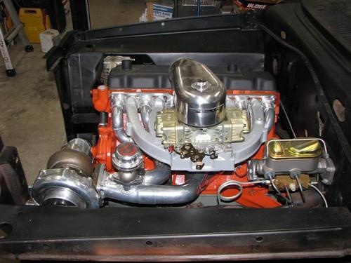

In my opinion, the best "bang for the buck" comes from turbocharging a slant six.
The cylinder head is the main obstruction to making good power, naturally-aspirated, as it has unusualy small valves and ports, and even with a professional port job and bigger valves, doesn't work very well on a 225 motor. It is, however, a GREAT head and has appropriately-sized valves and ports for a 170 motor. But, a 170 is a fantastic race motor with revs to the sky, it's just not big enough to be very practical on the street.
A turbocharger will let the engine sidestep the breathing problems it has and is a good alternative to hopping up a naturally-aspirated slant motor, I think.
But, it's not cheap, nor, is it easy.... There are a couple of expensive items that take it out of the picture if you're on a tight budget, but, if you have the coin to spend, I think it's a far better alternative than building a slant any other way.
My 15 pound boosted slant makes a little over 350 horsepower, which is probably a little more than what a full-race slant, naturally-aspirated could make. And, it has excellent road manners (idles like a stock motor and has tons of low-end torque.)
If you have any interest in a 10-pound-boost motor (you can use stock pistons and rods...) just ask here, and we can fill you in on the specifics.
OR, just ask Charrlie; he has forgotten more that I'll ever know about turbos (and, slants in general...)

Chuck, if you really want the benefits of turbocharging, you could use a stock cam; turbos work well with a stock cam. That would allow you to sell the aftermarket cam you have and get some of your money back.
As far as the packaging goes, there are LOTS of turbocharged vehicles that have located the turbo at the rear of the vehicle, just in front of the back bumper. That seems to work fine. That would free up the engine compartment for the A/C compressr and lines...
If you REALLY want the benefits of a turbo, there's a way...
My '64 Valiant has run 12-seconds flat @ 112mph, turbocharged with 15 pounds of boost. That would be acheivable with stock pistons, and is about 350 horsepower.
You pays your money and, you takes your choice...:coffee2:
