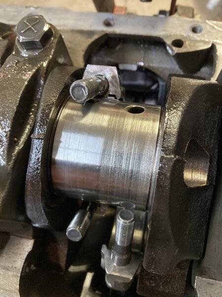

OK, not the end of the world. The good part the rod bearings are soft and took the hit. The crankshaft looks worse than it really is because of the small amount of bearing material that transferred to it. The bearing material on the crankshaft can be polished off and new rod and main bearings installed, also needed new oil pump too. A creative mind can actually polish that crank in the block without pulling heads or pistons, takes some doing but can be done. Takes some finger work, and some high density foam plugs to keep debris out of the oil galleries.

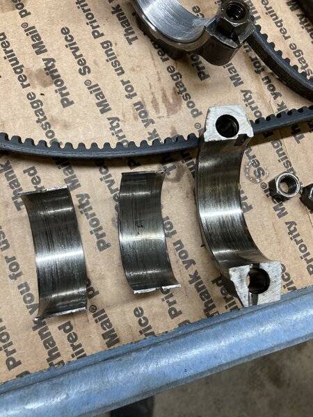

First order of business you want to see how far the damage has gone. Bottom half of the Main Bearings are the first to start to go in a low oil pressure oil situation.
Want to look into the cam bearing edges with a light to see if they ran dry peeling the edge of the bearing out like a banana peel, most suspect would be the front cam bearing as it is farthest away from the oil pump.
Check other rod bearings to see if it is an isolated rod bearing problem.
Can pull the cover on the oil pump to see if there is scoring in there from low oil supply situation.
But yes, want to determine why it failed then move on to a solution.
Good Luck
That just sucks, it does look like a bent rod. Ever been hydro locked ?
I had a rod bearing issue when it was first assembled and #3 and #8 rod caps were somehow swapped. Only took a couple hundred miles to wipe them out.
now I’m not sure what caused it this time.

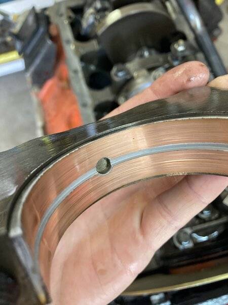

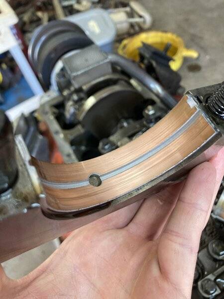

OK that is definitely an oil supply issue there on the main bearings you have pictured.
Cut your oil filter open and see what is in it. It could just be plugged. Check the paper element with a magnet to see if you can pick up steel debris.
What kind of oil pressure was the engine running?
If all the main bearings look like that, you can bet all the rod bearings are going to be scored too.

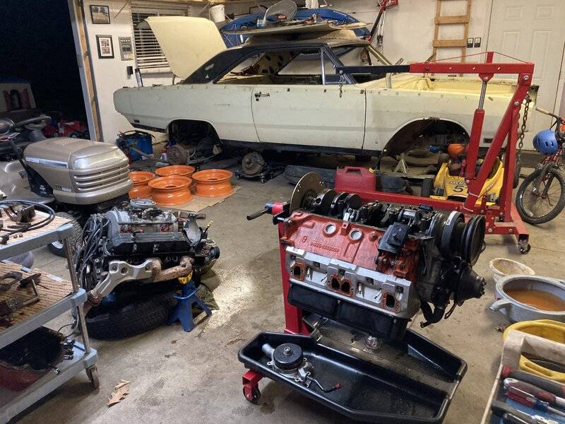

I had put together a barn find 360 engine for fun to drive the car until the snow flies but I hurt it as well (blew a head gasket and lost compression on #5)

But the question is - Why did the rod bearing spin?
It's the first time using a high volume pump. I'm guessing I sucked the stock pan dry while passing a minivan in high gear. Tach was climbing past 5500 before letting off and the knock started immediately after.
