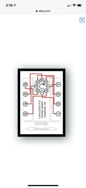

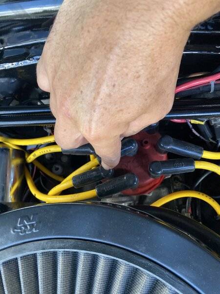

    Ok so car has been in the shop being restored for the past 15 months. So problem one is the old gas going through it. I put 91 octane in and some octane booster in. Motor is an LA based 408 with about 1000 miles in it. Brand new edelbrock 1906 carb. Car starts real hard, and has a desire to stall but once warmed up seems OK. Now I didn’t run the new plug wires and I was looking at them and, from the diagrams I have looked at, they appear to be off. Any assistance will be appreciated. My finger is pointed at #1 47985684-AAC5-4843-AC69-2C0B3627356B.jpeg

      Firing order is 1-8-4-3-6-5-7-2, for all V-8s.
      Small block distributors turn Clockwise.
      Big block distributors turn Counter clockwise.

        The location of the #1 wire on the cap might be off from where the cap says #1 should be, because the drive gear is not clocked correctly, nothing wrong with it just you and any person who has to work on it needs to remember

          Thanks for the replies. Makes sense. I just can’t for the life of me figure out the hard starting.

          ^^What Dana is trying to say is that the no1 wire does not have to be in the no1 "book designated tower" for the engine to be properly in time. Two things that pops up lately is "rotor phasing" (Google that) and MSD does not like "dial up" timing lights
          Other than that general tune up, cam timing, incorrect timing marks, and "just where is" the timing, what is the timing curve in the dist, and IS IT working in other words is the mechanical advance stuck
