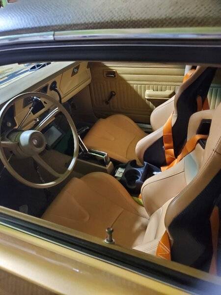

While waiting for my original seats to finish up at the upholstery shop, I installed the Recaro's that he finished for my 70 Duster.
I had bought these brand new back in the 80's, wear and tear over the years, plus mice made them unusable. He did a nice job restoring both sets of them.
