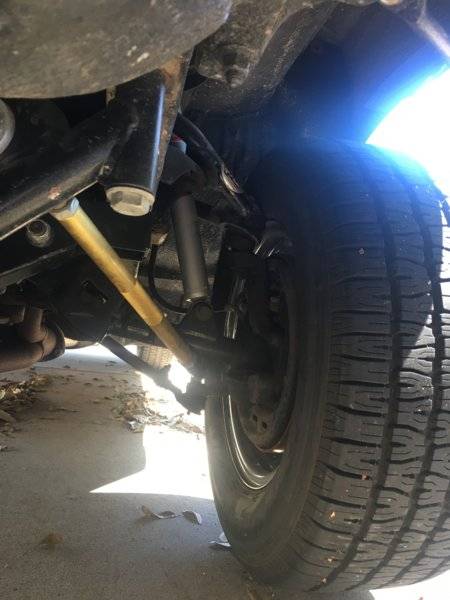

                        ED9EE45A-03A4-49D5-B029-21627A1F8DB9.jpeg B0F1801D-6423-4A30-AB86-BB4CD505DCA5.jpeg Well, I jacked the car up and turned the steering wheel and this is definitely a 24:1 box@ 5 1/2 turns lock to lock. Tires have 8 inches of tread on the ground

                          8 inches is a lot of thread on the ground. Are those the tires ur going to stay with??

                            I’m not in a hurry, but I would guess the tires are not helping. And. A rim size change would have to be done as well​

                              It looks to me that the PO had set this car up for road handling. The backend has a sway bar and is about the same height off the ground as the front

                                Not to mention the clearance is really close on the steering arm and upper control arm. In the picture, you can see that it barely misses touching the tire

                                  But I think trembling is onto something. A smaller tire and rim would certainly help

                                  And running max pressure will also help. I used run my tires just a little over inflated and it made a big difference because tires leak air slowly but surely.
