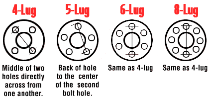

Here is how to measure the bolt pattern.
Thank you for the image, very helpful. How would I determine if it was smb or lbp then the backspacing needed? Basically I am looking around at summits and haven't had much luck in figuring out what would fit.

Does the car have disc brakes on the front. It should be a single piston caliper if it does so that would be large bolt pattern. If it has drums on the front it would be small bolt pattern.
Thanks, I think thats the rest of what I was looking for. Almost positive it has disc on the front. I haven't pulled any of the wheels yet but when I was under it the other day looking at everything pretty sure I saw disc brakes.
