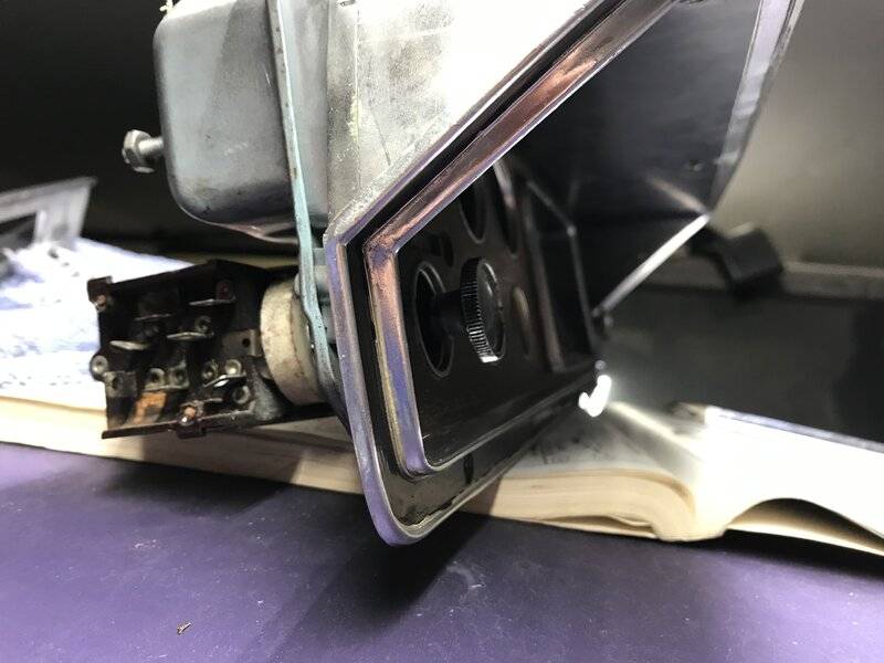

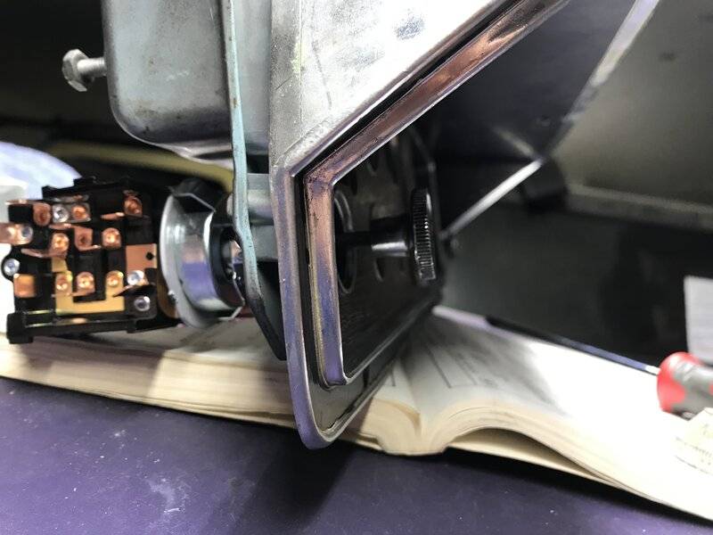

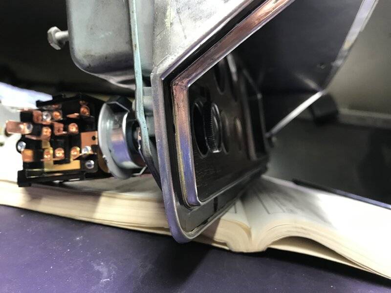

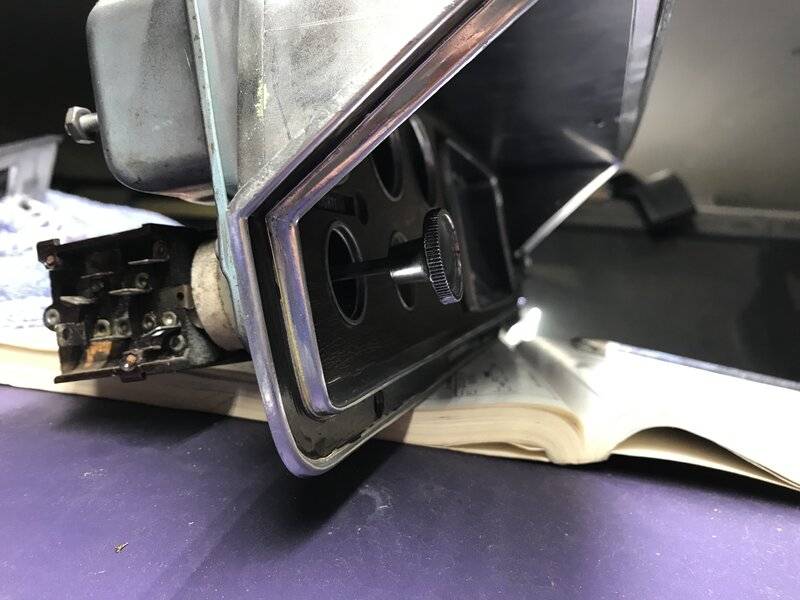

Before putting the Cluster back in a 75 Duster 360, I decided to replace the headlamp switch as the OE unit had a failed potentiometer.
RockAuto showed Standard Motor Products DS357 was the replacement.

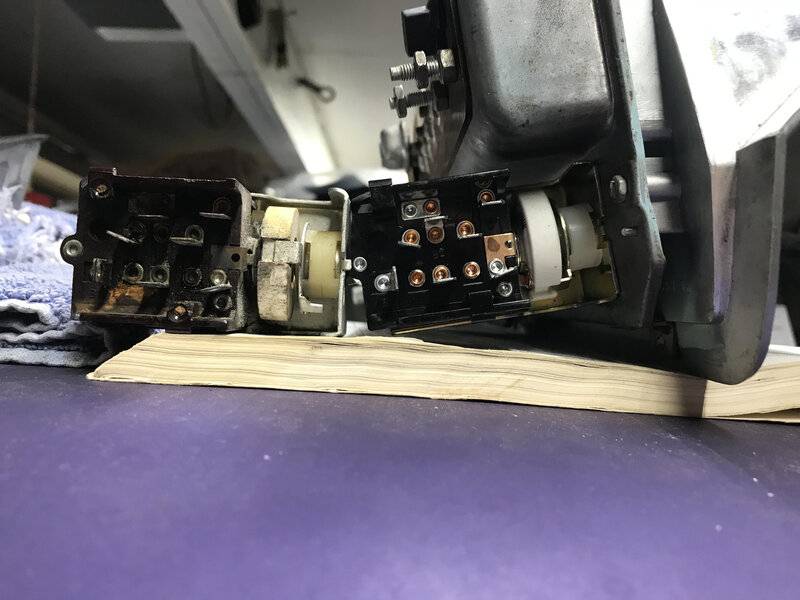

it’s slightly longer, but the fitment issue is that with the plunger installed , the knob is almost flush with the cluster bezel.
has anyone else come across this? Is the fix to find a longer plunger? The only other one I have is for a 74 Ramcharger and even with a conical shaped knob for slightly better access, the rod is the same length.
Here are pictures showing the knob in the off position and all the way out in the headlights on position. Interestingly enough the depth difference is the same as the additional length in the replacement switch body
It does, in the off position the knob is about flush with the bezel

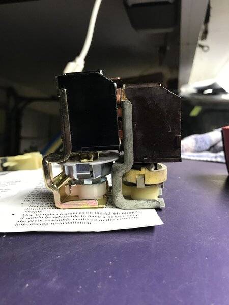

This is the Standard Motor Products DS165 that I just pulled out of my 74 Ramcharger. Napa part Number HL6571SB also appears to be correct and I'm going to get one of those to put back into the Ramcharger.
Bad rebox or Standard (as usual) has been dining at the Chinezeoatiized table
Then one of us got the correct switch in a DS357 box and the other didn't.
I spent too much time on this issue, the DS357 is not the correct switch.
The DS357 that I have has a hard to read number etched on the side of the switch 2018301 - 213C. Also, on the box has v20297 and the ups code is 9176908280.
Back in 2005 I purchased a light switch for my 75 Duster 360 that has a 72? Cluster. Part number SMP DS - 165 and it still works.! Hopefully this helps.
