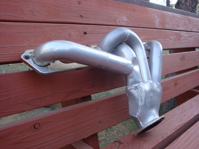

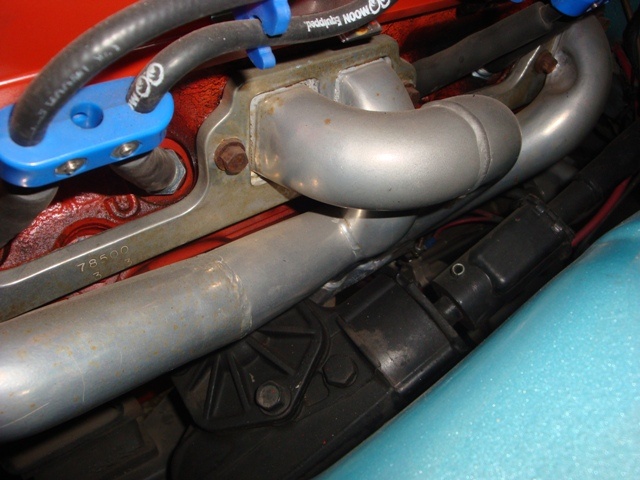

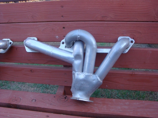

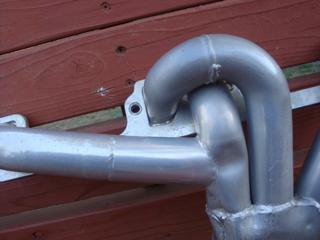

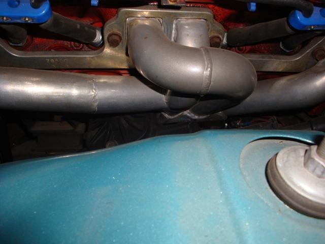

Like this. It fit like a glove but getting around the steering linkage tricky.

I should have patented them while I had the chance. :banghead: lol
Don't waste money on the coated ones (like I did) cuse' your just going to cut them up any way. I sent the left side back to Jet Hot to recoat after I modified them. I sold them to a member and have not heard how they worked out on his project. Good luck it can be done!:D

Thanks for posting those! That's exactly the one I was talking about.
