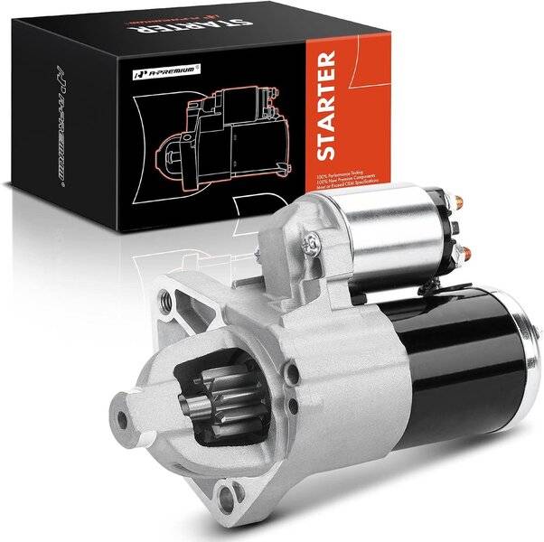

For 63-66 A bodies with 727s or with manual trans, TTI says you must use the RobbMc Performance starter #3005 - almost $400.
I'm not a betting man, but I'd still bet a case of beer one and/or the other of the starters I linked in post #4 of this thread will fit just fine, for like $310 less.
For some reason I can't link to the Amazon listing (and your links don't work either), but search for a starter for a 2005-2008 Dodge Ram with 5.7 V8 and manual trans. Several come up, including this one.
Those years will get you a plug in solenoid wire instead of a ring terminal (I think)
When I 5.9 swapped my 66 barracuda I pulled a starter from a junkyard 2006 RAM pickup and it had the plug. I grabbed the plug and a length of wire and spliced it into my harness.

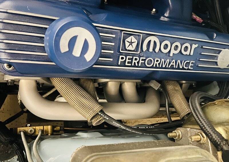

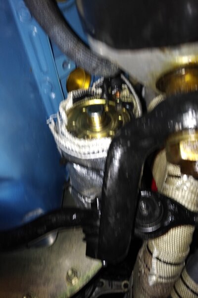

From my experience, starting from 1980 thru 1988, Chrysler made an aluminum starter heat shield. Tight fit around the starter and works quite well. Consider updating your battery to starter cable and also the negative cable too? Had similar experiences with my drag only 360/904. Usually hit the starter with spray bottle of water. I later moved to fenderwell headers and all problems went away. Fabbing fenderwell headers for street '65 now.
Struggled with this for years. 408, with TTI and TKO 600, RobbMC starter. Starter and header in area of starter is heat wrapped. Did not help. Battery in trunk so 20 feet of cable. Did some voltage loss checks and found battery not getting 12v to starter. This lower voltage fine for cold starter but not for hot starter. Added 1/0 cable, largest I could find and this fixed it. Now, it still struggles a bit if i am driving around town in hot weather, but it has never let me down since.

I built a 65 Valiant, with same combo you have, i put a couple of wraps around the starter, never had any problems with heat soak, i drove it on the street for years, and then my daughter got the car and drove for years, i did use a Dakota starter, maybe i cannot see good, but it seems like there is more room.
