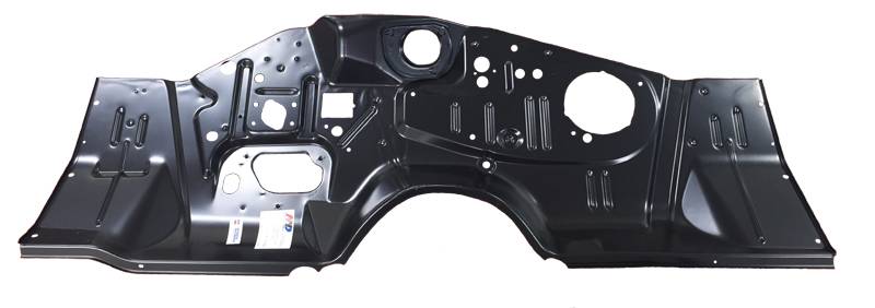

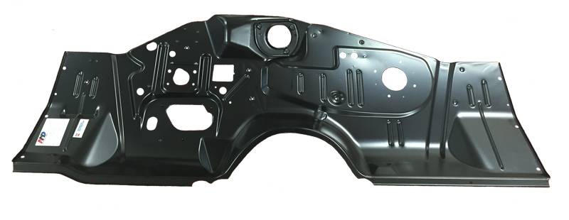

Here are pics of the firewalls (non-AC-bottom and AC-top) from the AMD catalogue (these are pics from the inside of the car). if you look carefully you will see that the surface where the box mounts to the firewall is even different
