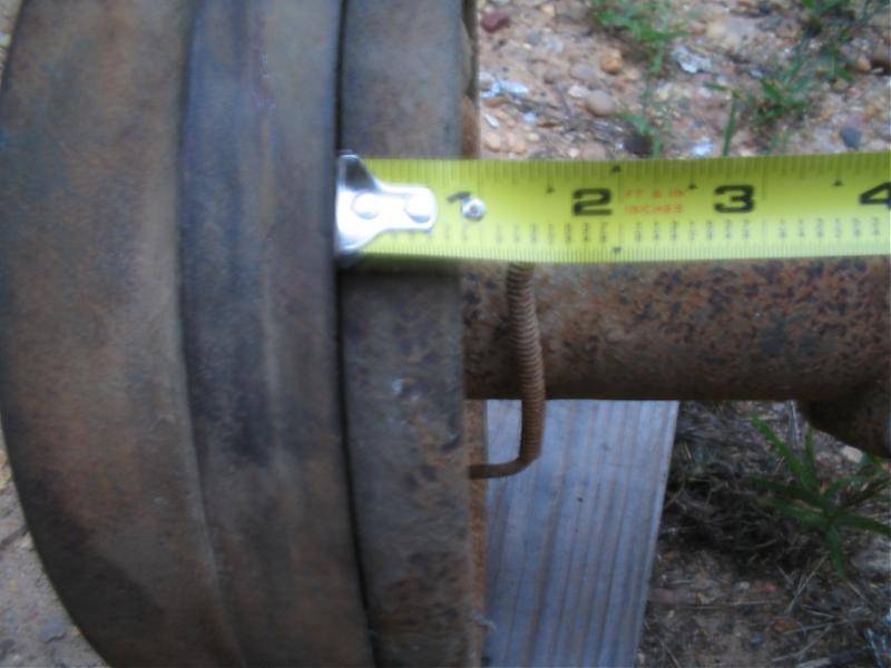

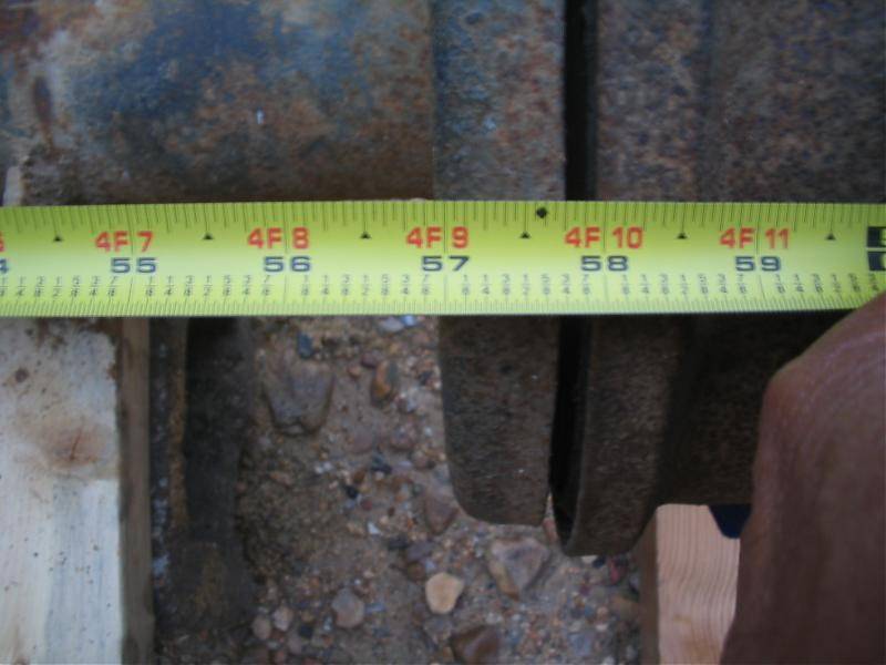

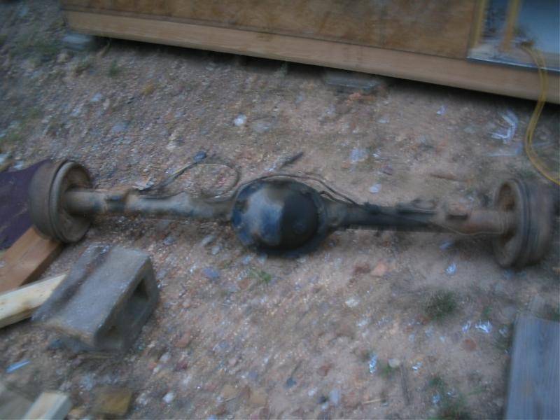

Well I have ran into a stop on this rear end.:cwm10:
I thought it would work in my 66 valiant but it is wider 5 friggen inches:scratch:
It is a perfect rear end and I thought I could use it in my 66 valiant.
I was going to move the spring perches in a 1/2 inch and know I see that it is 2 1/2 inches wider on each side. Could I get more back space and less front space on a wheel??
I think I will have to wait and find a 8 1/4 early A body rear:hmph:.

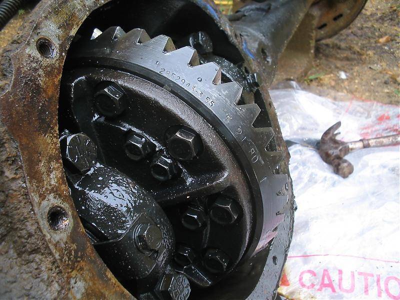

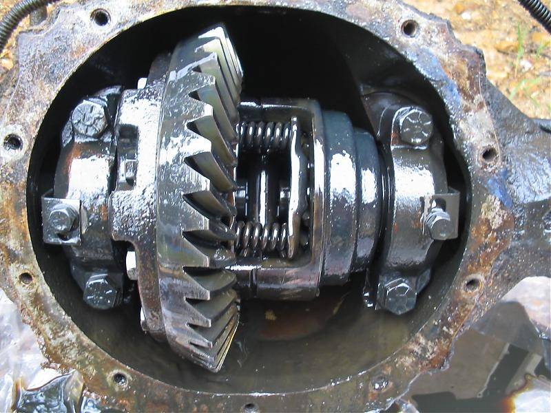

Can some one id this rear end, It was put in my old 1/8 mile truck.
I could just cuss up a storm @#$%^&
Thanks to grumpuscreature he seen this problem and let me know that I am going to have to modify this one.
Jeese I am getting goofy :angry1:

I guess the thing for me to do is pull the sure grip and 3.55 gears out and wait for a 8 1/4 to fit my 66 valiant.:sad4:
Mike it kinda sounds like it's probably a stock truck rearend by your description of it's size. I also see it has the spring perches on the top like a truck. Having it narrowed and perches re-welded would be cost prohibitive since you can find 8-1/4 rearends quite often for $200-300 ready to go.
