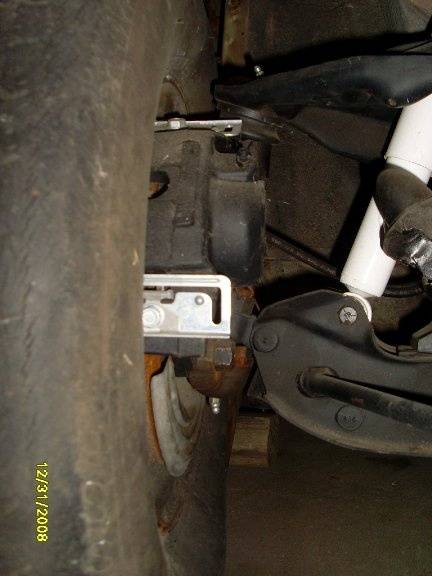

I understand what you are saying, and here is the passenger side of my son's '74 Duster - caliper towards front of car.

I just swapped to disc. from a 73 swinger,the caliper is up front.Here,s pics. hope this helps.Oh sorry forgot to mention,this is the passenger side..
