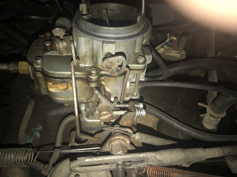

here is a photo of my 67 BBD
and a second photo of a 66 or 65 (not sure) and earlier BBD

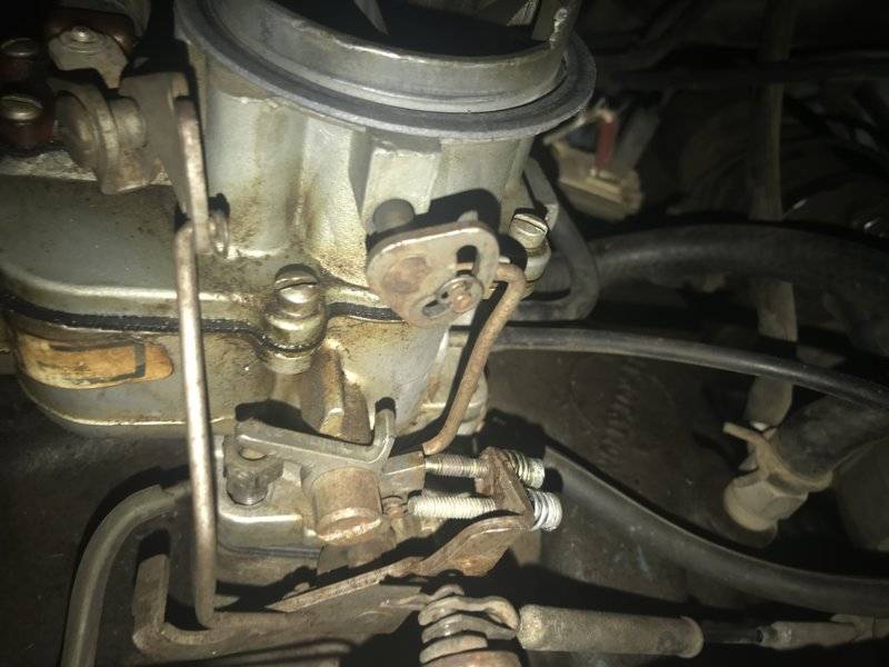

both of your idle screw looks way to screw in to me. look at my photo in post 6. Also your normal idle screw looks like it was ground down.

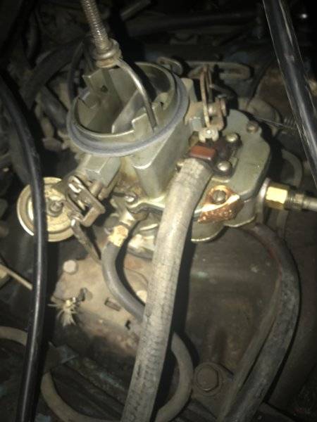

The pic above is where it is when the choke is open or closed and when it acts up
IMHO. if you have to have your idle screws in that far to idle than you carb needs rebuilding as it suggests the idle circuits in the carb are clogged OR you don't have the idle screws out enough. Assuming the idle cir is plugged you would need to open the butterfly more to compensate. a vacuum leak might also cause the same situation.

Let me reiterate that your idle screws are screwed way to far in. look at my photo and your photo for comparison..

Also just for the sake of it, the last photo in post 11 shows the front stud nut almost completely off thats because you had the carb off earlier and haven't bolted it back on yet?
