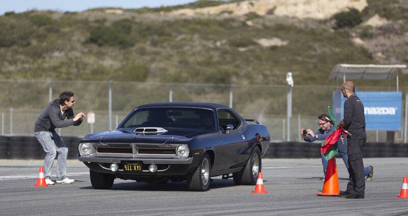

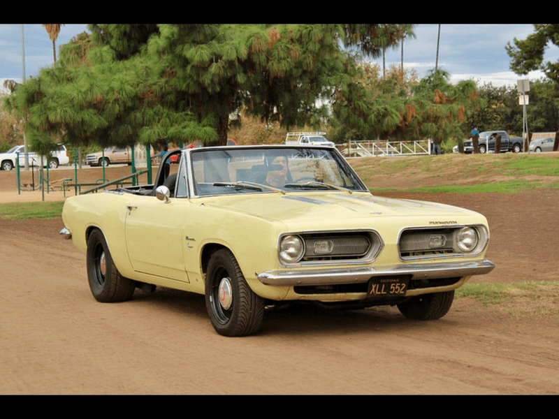

I run Nitto Drag radials on the rear of both my Mopars. They are currently rated as a V (149mph) tire. They used to have a higher rating.
On the front, I use V rated tires as well. Those are 225/60-15's there are quite a few V-rated 15 inch tires available out there besides the Avon tires, which are know to have issues with flat spotting when parked.
I've only exceeded those speed ratings a handful of times with no issues aside from putting my buddy's wife in shock once.
