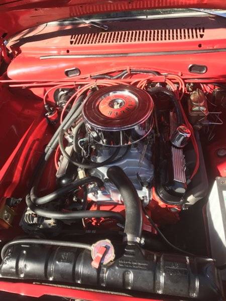

    I have an Eddie D4B intake I want to replace for my stock cast iron intake. I have the stock chrome charger air cleaner and the Eddie 1403 (500 cfm) carb. Anyone have this setup? Looks like there may be a hood clearance issue as the intake is higher than the stock. Yes I'm lazy and have not measured. LOL. ( this is my current setup).

      Throw a string over the fender tops. I guess I never checked. :BangHead::BangHead:

      I used the baseplate that a member was making/selling a couple of years ago.
      [FOR SALE] - Commando style baseplates
      helped me keep the stock air cleaner on the 1403 with the higher Offenhauser intake without using a smaller filter.

      My 65 Dart LD4B edelbrock 600 has 0 hood clearance issues am using stock chrome air cleaner lid, but with a chrome base I found in the garage.
