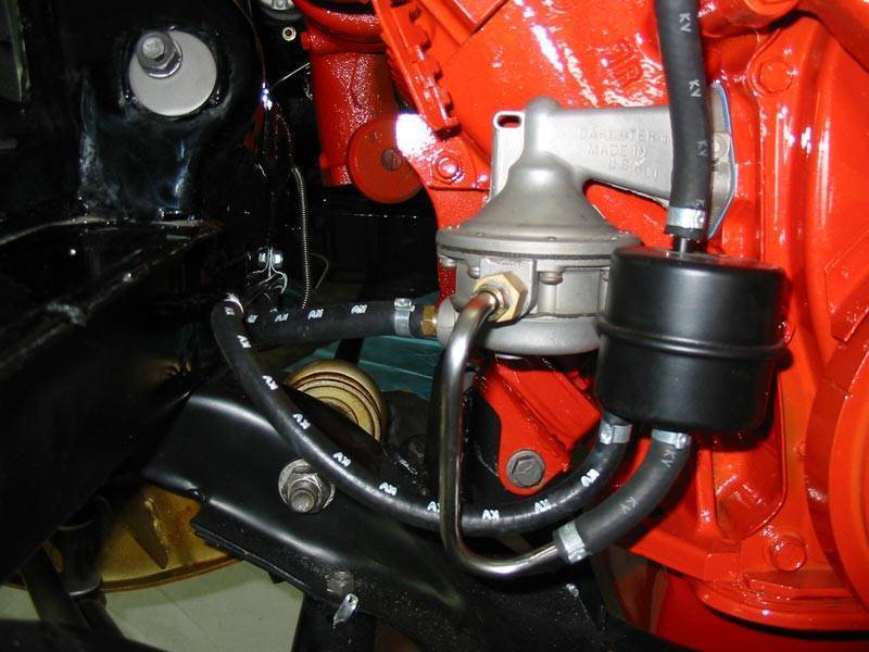

I'd also consider the three-nipple fuel filter as suggested in Mopar Action
This allows fuel to cycle back to the tank, so the fuel remains constantly cycled with cool fuel from the tank. People forget that fuel filters can percolate fuel too.

2. Installing fuel filter/Vapor separator used on 72-78 B bodies
I put my cell phone on the inner fender apron while recording and got a good indication of how much room there is to spare. You could stand a tape measure on edge for a more accurate idea.
If you find a source for the separator, could you post it here???
Thanks for the link! Do you have to have a charcoal canister or something to take the separated vapor?
