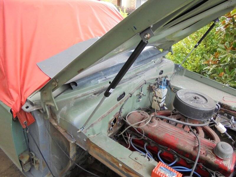

For the hood struts I used (as Tim did) the struts from a late 90’s/ 2000s Mitsubishi Montero rear hatch
This is what I did for the original hood as a test. Ended up shaping the mounts to look better. It's since been replaced with a custom fibreglass hood where the struts have covered mounts. These struts are 530mm long 350n pressure if I remember correctly, it's been over 10 years!

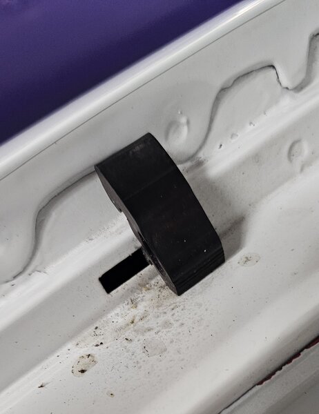

Hi Tim Going to go your way of mounting struts . Any pic of how you mounted to door jam? Or maybe just the location on jam.. you are correct much cleaner
I made post. But. Top mount goes in second hole in hinge. top most. Then prop hood open to where you want full open to be. The bottom mounts right against the pinch weld. Drill two holes bolt it in. Really easy...

How long have you had the struts this way up Tim? All supplier information I have read state they should be the other way up to maintain the lubrication to the seals. They reportedly will lose pressure quicker when the main body is not at the highest position. I have my struts exposed as the original plan was for a speaker enclosure to be where your struts are.
