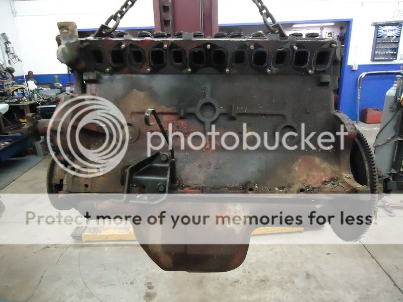

From one noob to another, yes, that's how I yanked the slant from my ride:
EDIT: I looked for a better image and discovered I was wrong, we used the head bolts near the ends, not the exposed bosses on top. Just uploaded a shot from the other side that shows it a little better. Sorry for any confusion.

It looks like your chain set up is ideal for an assembled engine. I was planning on doing some work in-chassis and decided to yank the mill instead.

I haven't had mine out yet, but I recall reading that there are 'correct ' holes to bolt into that are stronger points in casting. Doing it with the special bracket is supposed to allow you to balance it right for with or without trans attached.
That said, I have seen that some guys lift the car and drop the whole thing out the bottom. May be the way to go since you are pulling the K anyway.
The front hole is supposed to balance with out trans, the back hole with trans.
Ditto, did it and it worked out great, the motor was almost even balanced left to right. Use a grade 8 bolt and a heavy tab or hook.
