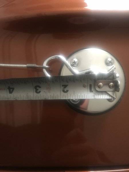

would anyone who has installed the hotchkis hood pin kit be willing to take some measurements? Basically i need to know the distance of the 4 mounting bolts for the hood plate across from each other. I have the generic factory style on now, was thinking maybe they are the same distance as the original style and would bolt right up in the holes i already have, deff cant re drill them. I was thinking of eventually picking a set up.

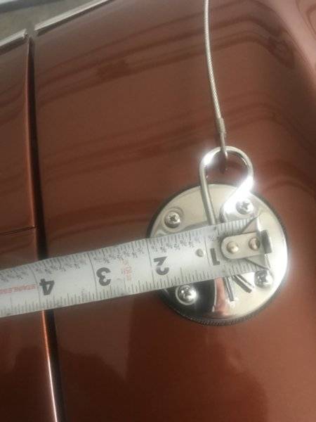

I have installed them on my '70 Dart. I used the stock hood locations but the Hotchkiss pin bases are larger in diameter than stock and they do not lie flat (you can see that in the picture). I had to massage them with a hammer to get them to lie flat.
What is the distance between the bolts for the hood plate?
Mine are at 2”
Also the plate is 2.5” in diameter, not sure if the hotchkis one is bigger
The car isn't here now, it's in the upholstery shop, so it will take me a day or two to get that measurement for you. But it is whatever Hotchkiss drilled them.

To do it right you have to move both the hood pin hole in the hood and the core support pin hole toward the center of the hood. I had to cheat because I didn't catch the mismatch until after painting was done. My upholsterer just called me back the distance between holes is 1 1/2 in.
Like I said I cheated and managed to put a slight bend in the base to fit the curvature of the hood peak. The risk was of course that I'd snap the casting, but that didn't happen.

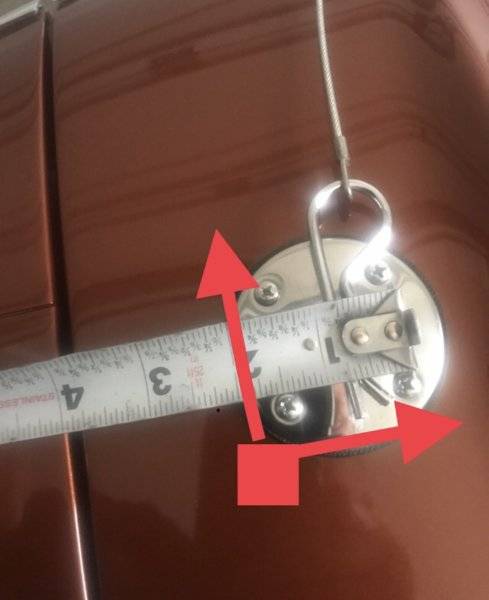

Which way did he measure?

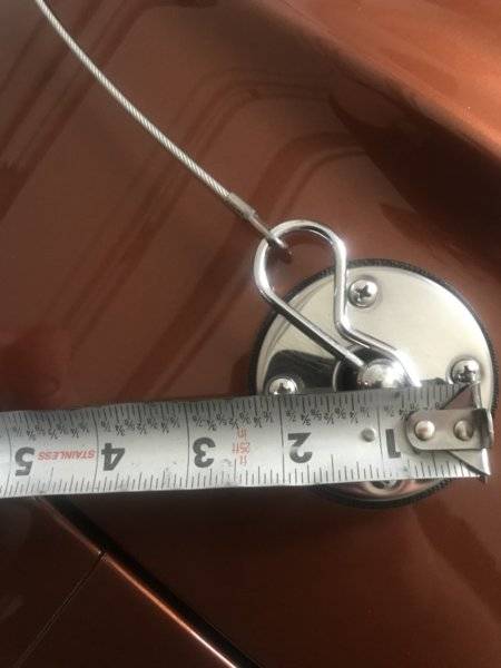

I get 1-1/2 this way
I asked him to measure both directions, he said the holes were "square" BTW I like your paint color

Huh, i wonder if he measured both directions like i have in the pics in the pist above, if the holes are square the distance from one hole across to the other hole diagonally should be longer than the distance from the holes measured on the same side
Mine are in a 1-1/2” square and 2” diagonally across from each other

He measured from hole center, (north/south & east/west) to hole center using dial calipers. I can't get anymore info today, he's gone for the weekend.

Thanks for getting the info, i think he just measure in a square.
Mine are 1-1/2” measured like this on all sides
Mine are also 2” across ftom one another diagonally
