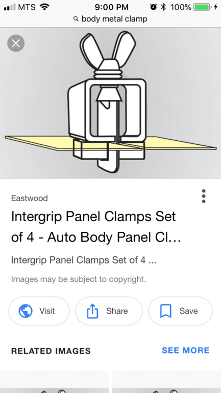

If you can get at both sides,these work well.
Made a few with scrap tubing and threaded rod.

I purchased eight of the clamps shown above by Tooljunkie from Eastwood. I am sure in other places they will be useful. The Brass idea is killer as I have a whole lot of trim holes to be filled.
