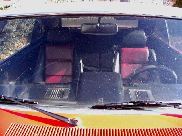

It looks like I'm about ready to load some pics of the progress on my dash pad area in a min or two here.
Athough I don't usually show things I do until they are done, but I'll make an exception this time.
Give a few and I'll load em up.

Damn my winshield is dirty. :)
I gotta clean that if the rain doesn't.
Ok, so here we are.
I picked up a tach, A/F meter and awhile back I added a new fuel guage that is currently temp attached above the wiper switch till I decided what I was doing.
In the straight on shot of the guages I added the image of the fuel guage into the guage cluster with a photo program just to see it with all three guages mounted.
That last pic, I drew and pasted so you can get what the finished dash will look like and be able to post the intended outcome with the carbon fiber sheeting and trim that will be stepped on the underside so it will make a nice frame attaching it to the dash.
I will use finer grain, but this is the idea.
I will probably end up fabbing an end cap for the two ends where the aluminum trim comes together at the outside ends.
The gauge cluster is hand made from a light steel computer side cover.
