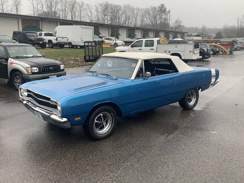

I have a 1969 dart GTS 340 four-speed convertible. 1 of 58 ever built. I have restored the car and have a period correct 340 in it with the matching numbers transmission. I have the matching numbers block but it has two cracks in it from the previous owner letting it sit out in the winter and freezing up. My machine shop said it can probably be fixed, they need to inspect it, and they said it will be expensive,
but their question was how much more is the car worth with the matching number engine?

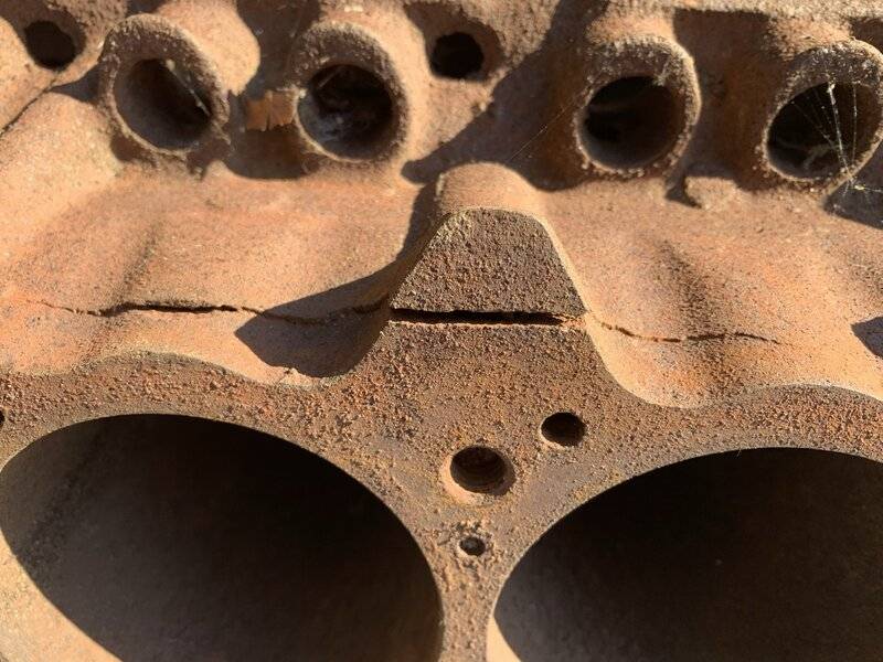

The car value isn't all that much more and I wouldn't trust that block if it was repaired. It looks like it's past the commitment cone to me.
I'm not an expert in vehicle pricing, but I would think that if you could get the block repaired for $2000-$3000 you would get it back in the sale price. That is really only valid if you are going to do it to sell. If you plan on keeping the car and using it, I would put the block in the corner and send it along with the car if you ever do sell it and let then make the decision. I don't know if that block can be repaired and be a reliable driver.
I have the same car in bad shape since I bought it in 1995, I would give $2K for the numbers matching block, been trying to find it since then and committed the VIN to memory 306021. I also have a 69 Dart GTS 383 4-speed and the block cracked in 1979, had it repaired at Indy Cylinder Head for $300 then, the cracks were about an inch south of where your cracks are, and it was fine after that. Your cracks are in a pretty strange place and MUCH worse than mine were though...

First let me start off by saying you have a very beautiful and rare Dart. My original block came to the same fate in about 1984 a very cold winter in Oregon and I was young and allowed it to sit out without proper antifreeze causing the exact same cracks. Unless you're restoring your car to try to squeeze the maximum price out of it or maybe you're just one of those guys who is wanting a matching numbers car then just keep the block and move on with a era correct 340 that hasn't had major repairs. If I was buying the car I would rather have a sound replacement than a repaired original.
"It can probably be fixed"
I'm goin out on a limb here, but IMO, that block is DONE. Over and OUT.

In mopars, numbers matching means everything. But that block looks beyond reasonable repair cost wise. Not only repair the crack but all critical machined surfaces need to be checked/recut. That includes cam tunnel and lifter bores. I would have it tanked, fogged and bagged then put in the corner. Let some numbers fanatic with deep pockets repair it after you are done with the car and send it down the road.

If a shop says it “probably” can be repaired, then look for another shop.
there are cast iron repair shops that do great reliable work, just find a good one and have it done.

I would let the next owner decide if they want to spend the $$ on a repair, personally I doubt it's salvageable, but definitely a part of the car's history. I've scrapped similarly cracked blocks, not worth it IMO.

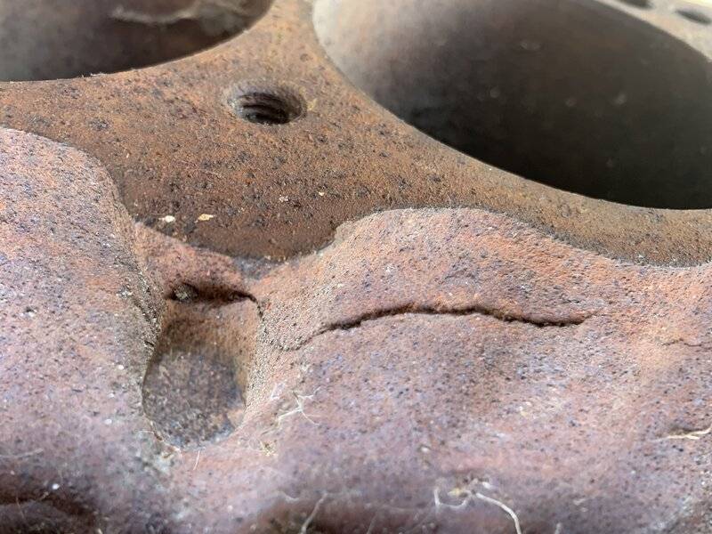

I am not selling the car and that’s where the block is sitting in the corner right now and if I ever decide to sell it it will go down the road with it I just didn’t know if it was worth fixing. I agree with the previous comment I might not trust it after it’s repaired. I wouldn’t want to put tons of money in it and have it fail. Thanks for the input
