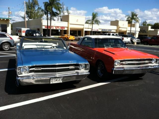

I originally used aircraft stripper to clean mine up and left it unfinished for a while (see pic 1).
But then finally found time to paint it. I preferred to go with a more blacked out version (2nd pic) as opposed to original that is on my buddies car on right.
I used satin black and argent silver. Heres my restoration link (#73) with some addtl info:
http://www.forabodiesonly.com/mopar/showthread.php?t=82832&page=3
Hope this gives you couple ideas. Doug

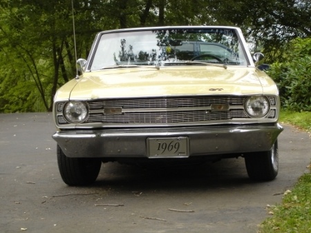

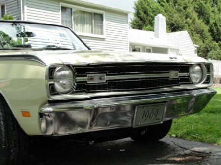

This is before I wanted to put the grill back to original and had the car painted. It is an original stripe delete car. I've always liked the white stripe so I had one put on with the new paint. Anyway I used a brush to paint the grill like this back in the 70's and it stayed nice all these years until I put it back to the original look.

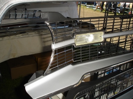

This is what I based my resto on. I took a pic of a restored one at the Mopar Nats last year. The guy wanted $800 for the grille.
More close ups of original versions would be appreciated.
