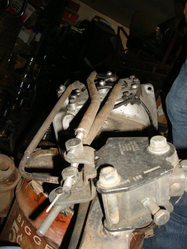

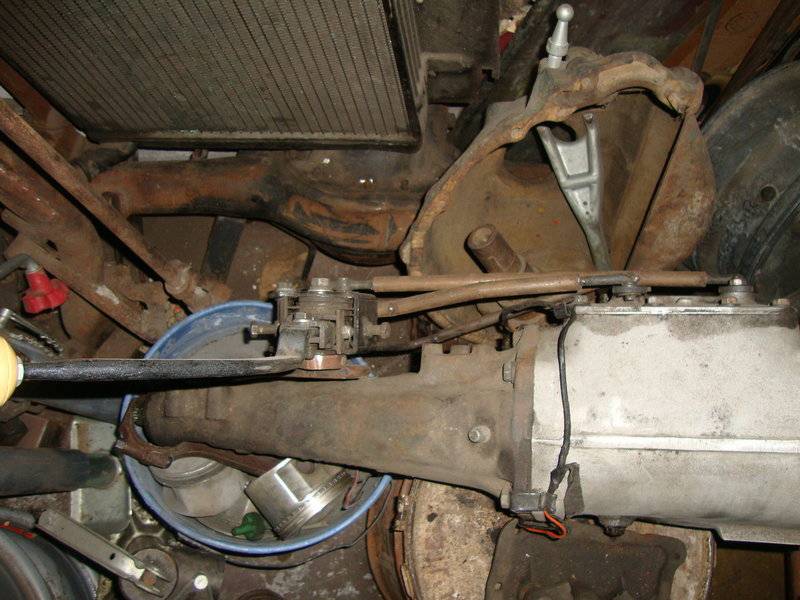

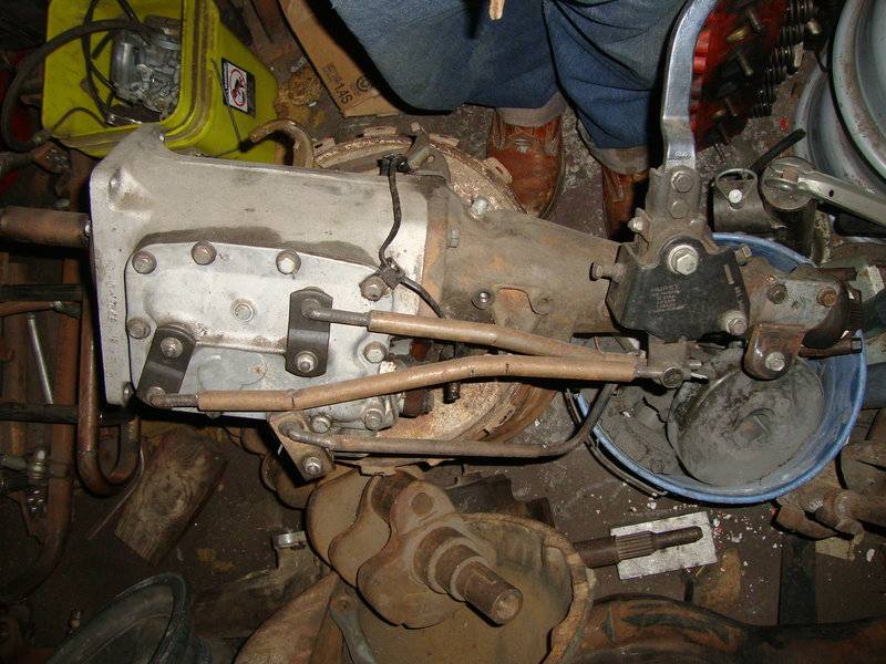

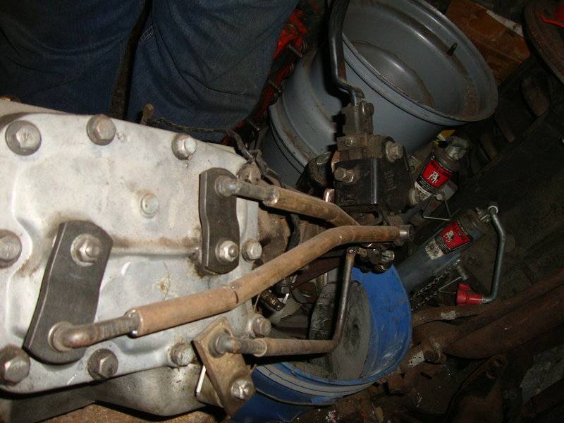

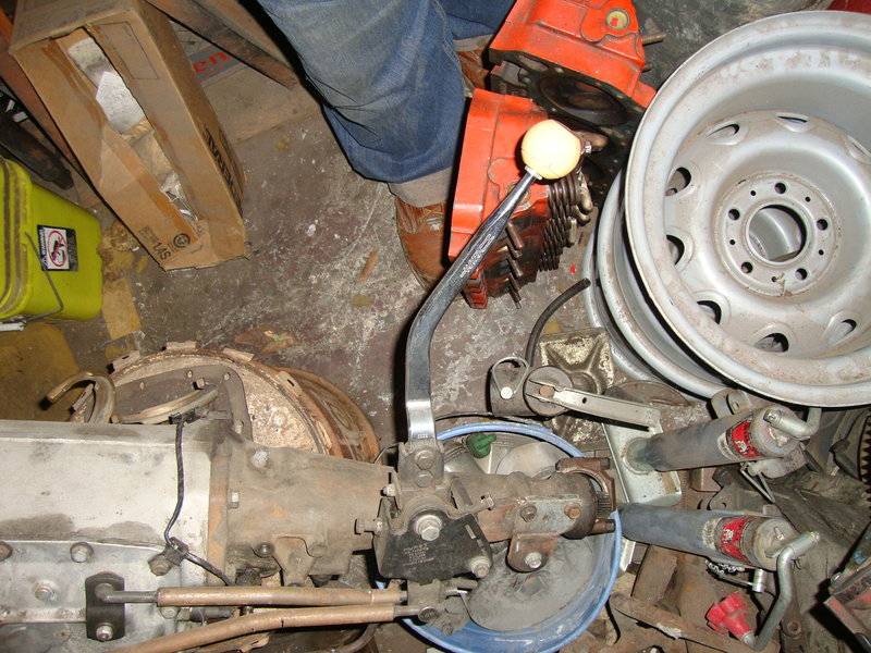

hemidenny , i've been cutting the rods and sleeving then with thick wall tubing , too get strong rods to what shifter i'm using . here is a pic of a long tall od with my rods and bracket for an a body . you can see how short the reverse shifter arm is on this comp/plus . still need to finish weld them up .
Is your front linkage on upside down?.......if not, maybe mine is
no the od flips 3-4 , the standard gear package has them all up , lol . had to look , make sure i didn't screw it up , lol .
I didn't realize it was an OD trans....my bad.
I did not even notice the aluminum case.

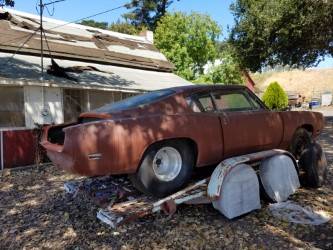

hemidenny , keep both eyes open , please . i think i said that it was an od trans , i did , what did you think i have a long tall od dog or cat . got some bob talled cats , no more dogs though , lol . hey on another note , i looked at this h code 69 formula s cuda , cut for tubes twenty plus years ago , there took all the rear section of frame and floor wheel houses and rear seat set up from the rear foot well back was cut out and replace with narrow *** frame rails and ladderbars and leaf spring still , caged , cut up front inner fender wells . no motor/trans or brakes , seats , dash shell , no good trim or grilles , rusted chrome bumpers , a rolling basket case . no rust showing on the body . guy wants 3500 for it . whats your thoughts on this ride . your duster has had major floor and rear frame mods .
