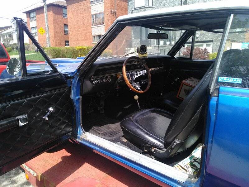

This is a Hurst super shifter 1 that I purchased in the late 70's. Yes it's a little bit of a reach but with the shorter shifts and short handle it makes the shifting quicker. I like it.

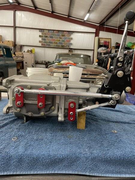

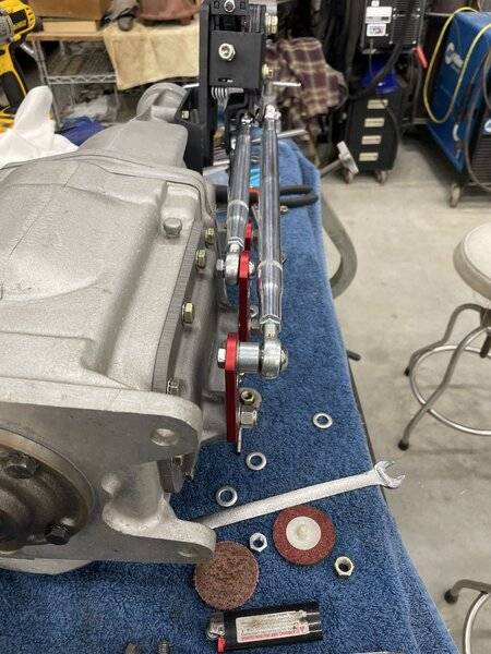

The Vgate is HUGE and I couldn’t think of a way to make one fit without cutting the car up so I held out until I found a Ram Rod here on FABO. The RR is very close in size to a Super Shifter so it fits in the OE hole in the tunnel (but it’s very close though) and I changed the mount to move the shifter up further in the hole.
That made it easier to get the shift rods almost straight. Not quite straight but pretty close.
BTW the RR replaced a Super Shifter III. IMO the best inline and the best H pattern shifters.
Thanks for the pics! I can see it sits a lot lower , my exact worries. I'm wondering if I could use a slightly longer straight hurst handle with the setup.
