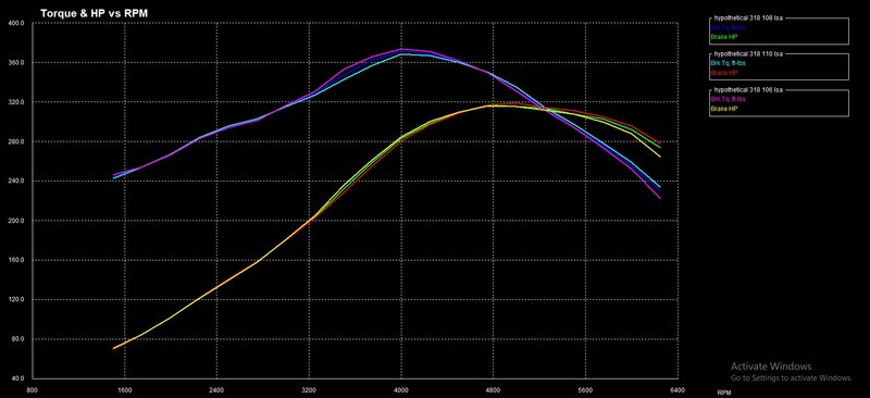

Hypothetical engine needs some hypothetical simulations.... so this is without a detailed cylinder flow table, just a constant number scaled from 340 heads with 2.02 valves. I thought based on cylinder volume and valve diameter that 106 LSA was too tight... ran it with 108 and 110 LSA as well.... you decide what you care about... a bit bigger peak HP number at higher RPM or more lower RPM torque.... can not figure out how to not have for forum downsample the image so it looks blurry
Can you size that for blind folk?
Oh and when running this model you MUST, MUST have headers to crest the 300 HP line or you may not make it. Stock 340 manifolds capped you at about 290 HP

Did you do a lot of work to the heads (or aluminum?).... with stock'ish heads that will be too much cam and won't be able to use what it is trying to give. it will destroy lower end torque in the process... theoretically...
Hypothetically I'll be using PBR's worked over Speedmaster and matched LD 340 intake
@fishmans67 318 with a 255/255 0.375 lift, 11:1 (important to note that cam duration and compression ratio must be matched... this cam with 9:1 would suck), single plane intake, headers, 2.02"/1.7" valve with the assumption that the head can flow way more than a stock head.... vs @RustyRatRod's street build. This is a great comparison to showcase what you lose to gain high RPM HP numbers. What is important is up to you in the build. You rarely get something for free.... for me I want under 4000 RPM torque so I always choose lower compression and a shorter duration cam (to keep the cranking pressure under 200 PSI) to maximize the torque curve in that area. Rusty wants to wind it up a little so he has a bit higher compression and a bit longer duration cam where @fishmens67 is after all out high RPM horsepower and willing to compensate for the loss of torque at lower RPM with lower gears. I cruise for hours at 80 MPH so super low gears are not an option for what I want out of my builds. I hope this is informative for someone in their builds... it is all a compromise. These days to it's not difficult to get a first order prediction of where you are with simulation tools. The magic is the second order secret tweaks to get that slight advantage where you want it.
