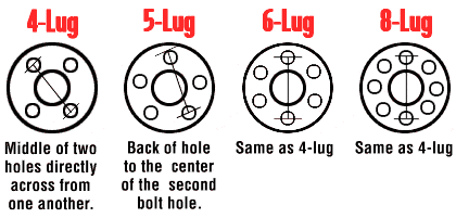

can I bolt on regular 14 inch rims, and hunt for some 14's..do I need to look at going to a R70 height because of the diameter increase..?
will /Chrysler/Plymouth/Dodge 14 inch rims all be the same...?
