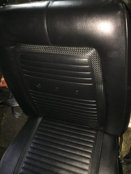

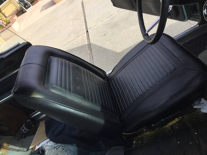

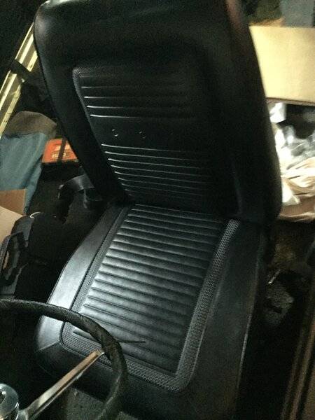

Well here’s the photos of the seat back together I have to do some work to the floor so I’m just putting it back together once he did time right now. The floor is cracked where are the seat mounts to the sheet metal so I need to get that fixed. Here’s the photos of the seat.I put the seat in Super Bowl Sunday ran out of time to vacuum that’ll be my next chore.
