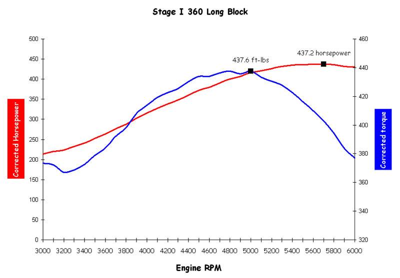

Here's a Hughes curve;
Check out the 170# at 3200. If you hit the start line with a 3200TC and 4.30s, you would be generating 170 x 2.45x4.30=1790#
But if you swapped that 3200 out for a 4000, you'd have the potential to put down 320 x 2.45x4.30=3370#.
So if your chassis and tires were able to deal with that, it would be reflected in the 60ft.
Now extrapolate that torque curve down to an imaginary 1750 rpm. Well you can't cuz of the dip at the tip-in, but Lets say at 1750 you made 80 ft lbs. Now with the 2.45s,you are down to 480# on the line. And if the bigger cam dropped 20 off that, then you are down to a dismal 360# You almost have to wonder how it can idle at all.
