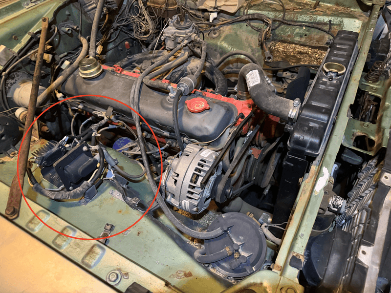

Jul 20, 2024 #1 D DigitalRelay Well-Known Member Joined Jul 19, 2024 Messages 132 Reaction score 157 Location Phoenix AZ Does anyone recognize this ignition system? I don't see any labeling.
Jul 20, 2024 #2 halifaxhops It's going to get stupid around here! FABO Gold Member Joined Jan 20, 2014 Messages 96,638 Reaction score 83,396 Location Hoppyworld, PA GM HEI home made set up/
Jul 20, 2024 #3 D DigitalRelay Well-Known Member Joined Jul 19, 2024 Messages 132 Reaction score 157 Location Phoenix AZ Awesome, thank you! Reading this now... HEI Electronic Ignition Retrofit How-To -Slant Six Forum
Jul 20, 2024 #4 jpl572103 Well-Known Member Joined Jun 26, 2023 Messages 178 Reaction score 101 Location Hampton VA I’ve got a not so similar HEI set up. Last edited: Jul 20, 2024
Jul 20, 2024 #5 Demonracer 71 Demon 00 Ram 16 Chrysler 300S 05 Caravan FABO Gold Member Joined Jan 31, 2010 Messages 7,951 Reaction score 7,023 Location Cleveland, Texas It looks to be an older cobbled together CDI ignition system with the heat sink exposed to bleed of the heat they produced. We had something resembling the picture way back in the 70s.
Jul 22, 2024 #6 B Bewy Well-Known Member Joined Jan 1, 2021 Messages 7,023 Reaction score 4,765 Location Australia No, it is GM HEI [ which is not CD ]. You can plainly see the angled terminals used by GM, in both set ups.
