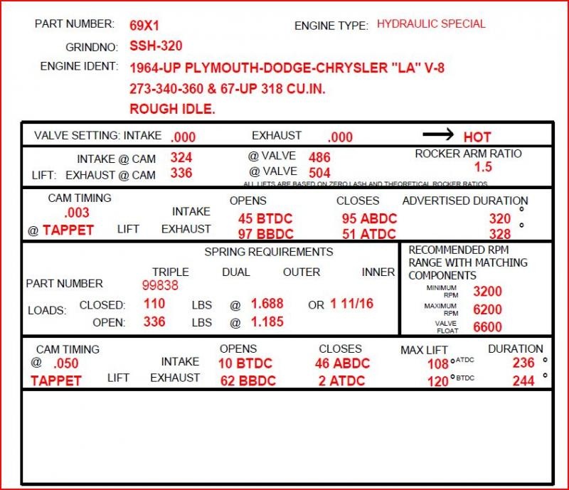

L LA340 Member Joined Aug 21, 2011 Messages 22 Reaction score 0 Location UK Jan 7, 2012 #2 Hi Sorry to hijack your thread. I am trying to identify a Crane hydraulic cam in my 340 that has similar numbers. Hydraulic version of the one you have possibly??? SSH-320-NC Anyone help us out please?

C crackedback FABO Gold Member FABO Gold Member Joined Aug 7, 2005 Messages 19,183 Reaction score 5,928 Location 92201 Jan 7, 2012 #3 Call Crane 386-258-6174 http://www.cranecams.com/contactus.php http://www.cranecams.com/literature.php If I'm right the SSH-30 is lift - int 486 exh 504 w/1.5 ratio rockers Dur - Int 320 Exh 328 Dur at .050 - int 236 exh 244 108 installed lobe center 114 LSA

L LA340 Member Joined Aug 21, 2011 Messages 22 Reaction score 0 Location UK Jan 9, 2012 #6 Thanks for the response crackedback, I contacted Crane by their web site and had a fast email reply with the cam card attached. For the record here it is for SSH-320 Attachments Crane SSH-320.jpg 125.6 KB · Views: 1,618
