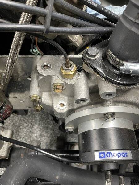

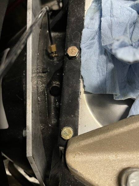

The custom fabricated dash in my race car already has warning lights for water temp and oil pressure. I have decided they might as well be functional. I run mechanical gauges but I have found some relatively cheap ‘kits’ with senders and wiring to run the warning lights. My question is, where to mount them. There is a plugged hole near the sender for my temp gauge. Is this an option for the sender for the warning light? Similar question for the oil warning. Opposite where the oil pressure gauge sender is a plug. Wasn’t sure if they go to the same place where I could run the sender for the oil warning light there.

It looks like the plugs you point out might work.

I agree, u can get Mopar sending units for the lights that will screw right into those ports. Sending units for a gauge are different so make sure u get the right ones. Kim
Sounds good Kim. I just wasn’t sure, especially on the oil ports on the back of the block. There are two ports opposite each other and one is currently just plugged. Could it be as easy as just threading a sending unit into one side and leaving the pressure line hooked up to the other?
For the oil pressure just install a tee into the back of the gauge and install the sender.
I have never thought of this, but did notice that some of the kits come with a tee fitting.
I thought I had seen a tee fitting used in the block and assumed that’s what that was for I guess.
