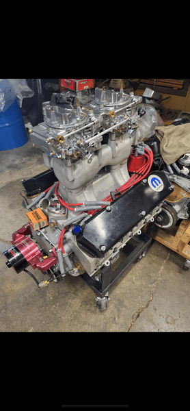

I had my builder install a Edelbrock tunnel ram on 360-1 heads for me. He just had to open the bolt holes some.
I can post some close up photos if it helps.

The head ports are bigger, but as my builder said, it’s better for the head ports to be larger than the intake ports.

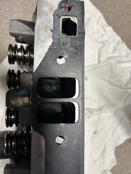

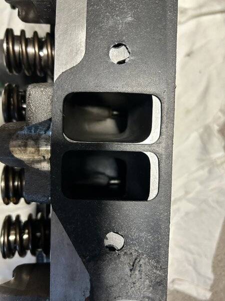

These photos are the Indy heads with an Edelbrock LA gasket.
It has been on the dyno and no oil leaks or any problems.
I do have the intake that comes with these heads but wanted to keep the t-ram if possible.

@coloradohill Thanks for the pictures. That helps a lot.
@sin The intake manifold bolt holes can be modified with a die grinder and the proper bit for aluminum to oval the holes to fit.

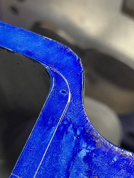

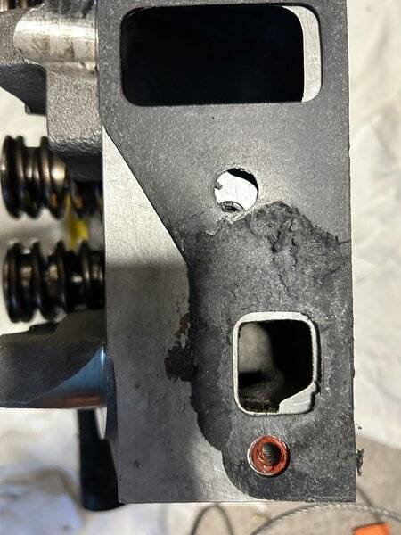

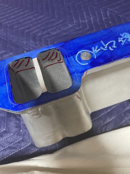

The port alignment can be adjusted with epoxy if need be. It is a common practice. My W2-MP-TR epoxy work below to align the ports to the head.

My concern is that matching the ports will make the manifold thinner, resulting in lack of strength and leaks.
Stop at .030 wall thickness. You’ll be Ok. If the ports do not expand out to the Indy heads ports, so t worry about it. Just try and get the middle and roof there first, side walls second, floor last. As it is of the least concern. The roof is most important followed by the sides and middle.
