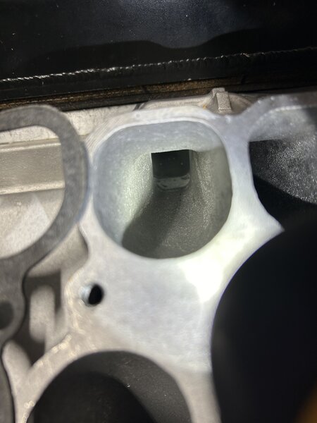

Your intake ports can be smaller than your head intake ports and that's not going to be an issue if you can get the roof of the intake port to match the head port that would be good, but
absolutely not necessary. It will just create more air speed if the intake is smaller than the head. DO NOT cut the floor of intake port out trying to match the head.

Thank you for the information. I really want this project to succeed.

100% on the floor. If you’re a pro porter, have at the port. If your a home porter, just the roof and sides will do great.
Sin, a smaller port is not a bad thing. (Within reason of course)
As Tom said, the increased velocity of a smaller port has a good side which results in a better throttle response. The higher velocity also helps atomize the fuel better and the intake design of a tunnel ram has a good straight shot to the head.
If you can’t get the port to match, it’s not a huge deal breaker.
It’s a minor thing not to worry about.
Do what you can without going crazy and all will be fine.

@sin and @rumblefish360 So I had a little time this afternoon to work on my engine. I installed the top of the tunnel ram and when I looked into the ports, I can see that my builder did in fact match the ports.
I haven’t had a chance to talk to him about it but, I see he epoxied the floor like rumble talked about.
It’s about 1/2” - 3/4” area. It’s hard to get a good photo but I think it will show.

Thank you for the picture.
It's well taken! It's helpful.
