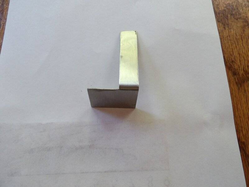

Sometime back, I put the Inland Shifter back in "Ole Blue".
When I did, I just guessed at the linkage adjustments.
The other day, I remembered that the service manual had a drawing of an alignment tool.
Here is the page from the manual and photos of my "Home-Brewed" version
I made the long tab 2 3/4" long with a 1" x 1 1/2" tab bent at 90*.
This makes for easier removal after adjustment and works Great...
