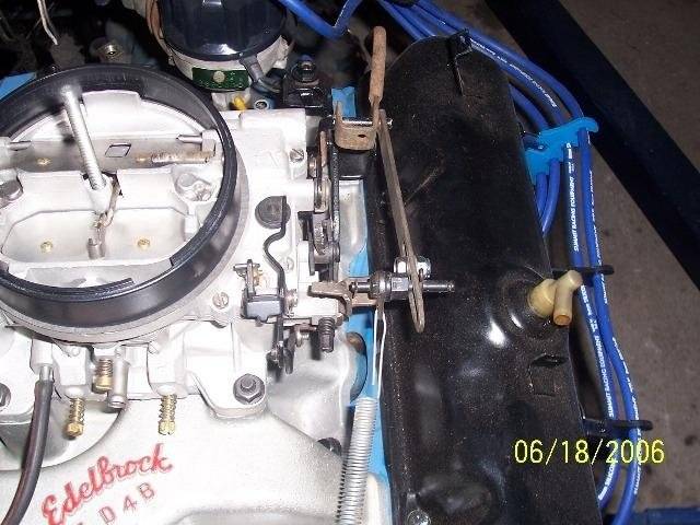

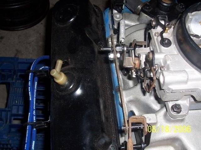

Heres what I did. A lock nut or nylon nut on a bolt moved up to meet the throttle arm for quick to instant pressure on the linkage. Ugly, but it works like a charm should.
Later, I purchased a Lokar kit for the gas pedal and tranny linkage.
Expensive but preeety and shiiiiiiiny. And expensive...wait, did Isay it cost a bit.....
Notice how I had to make a plate for the OE AVS. They do not have an adapter for old OE carbs, but do for modern Carter or Edelbrock carbs.
