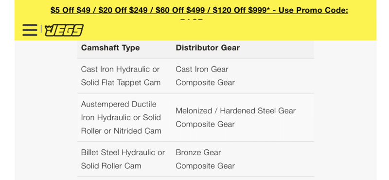

The brass shavings are likely in the oil filter. If you have a billet roller, you have to run either the brass gear or a composite gear. I think those are your only two choices with a billet core. Did you ask Oregon what the core is? They can grind cams on any core you want, so you need to be sire.

He said to run a steel gear, which I understand is the melonized one. I called 440 Source and they verified that I needed to get the shaft that Hughes Engines sells. I also ordered a standard oil pump. Hopefully it makes enough pressure to satisfy the top of the engine! I'd hate to go too low and ruin my Harland Sharp rockers!
