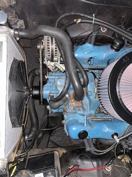

Is these a low profile water pump and pulley for a 360 engine? I’m trying to fit a shroud and fan between my radiator. Right now I don’t have any space. The engine is moved all the way back.
THERE IS NO REASON in the wide wide world of sports that you should have to mount the electric exactly inline with the engine pump. And you ought'ha have a shroud on there
If you cannot do anything else, measure, with fan "back" as far as you can, and off to one side as far as you can, and have / or fabricate a sheet metal shroud and mount the fan on the shroud. "You may" have to build some floppy rubber / hinged "check valves" on the other side to allow free flow of air through there at speed

There is no way oem copper brass rad and mechanical fan will fit in that tight space. What’s the thickness of rad, fan and shroud. I’m only working with 6” max

Yeah the cars had a 340 or 318 and the motor was farther back. If it was back a inch more I wouldn’t have this issue. The engine is all the way back on the engine mounts.
Can you send me a link or brand shorty clutch fan you used? I might try that.
The short clutch you want is #2947. It's about 2.75" tall and Hayden's "heavy duty" clutch engineered for a steel fan. The 2765 Jag clutch is a standard duty clutch and not designed for a steel fan.

LA 273,318,340,360, all the same size block... I’m running a Be-Cool direct fit, and dual fans, with March pulley’s, had to clearance one of the fan housing back fins and have about 1/2 inch with a shity ruler from the pulley to the back of the fan housing. Like this setup in the link below. Spendy yes, over heating problems, not a chance and I’m only running distilled water and Red Line Water Wetter, can get the temp over 175.... it’s also how my car was setup when I got this one 4 years ago...

Do not use the Jaguar Hayden 2765 clutch fan. It is not heavy duty enough, and your car will run hot.
Get the heavy duty Hayden 2947. Much better choice.

The 2947 is a real bear to install if you have a 7 blade fan. Very little room to install bolts. I had to go to studs to get mine on.

I have a good electric fan on it now and it’s still overheating. A shroud won’t fit with the electric fan.
