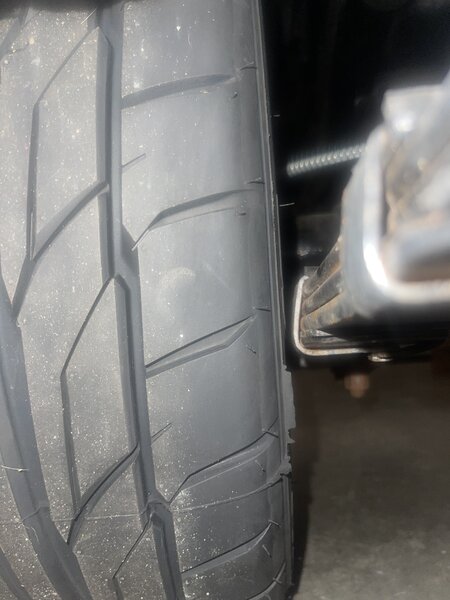

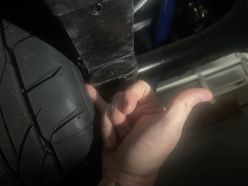

I have a 1971 Demon 8-3/4” rear with rear disc’s. The wheels are vision legends 5’s and in the rear they are 18”x9.5” 5.72”BS/+12 offset on Nitto G2 275/40R18. Are these too tight to the leaf spring? I dont see tires side flexing that much to hit the springs but wanted to know other opinions. They are pinky spaced or 1/2” from spring. Do i need a spacer or they are fine? The fronts are perfect at Front 18”x8.5” - 5.55”BS/+20 offset Nitto G2 245/40R18
the pictures are deceiving,they almost appear to only have a few hairs of clearance but in general I would say that 1/2inch is enough if that is what you see
I would suggest to take it slow, maybe drive around the neighborhood and hit a few speed bumps and dips and take it straight home and inspect again for any signs of rubbing, then continue to step it up to freeway speeds doing the same process
Pictures can be pretty deceptive when looking at that amount of gap. It doesn’t look like you’ve got a 1/2” there.
That said, if you do in fact have a 1/2” to the spring, that’s enough clearance. When I was running drum brakes still in the back I only had about 3/8” between my springs and the 275/35/18’s I was running and never had any issues there.
The shorter sidewalls you get with 18” rims don’t move around as much as what you usually get with a 15” rim, but also remember that the springs themselves flex and those leafs slide around on each other and can shift around a little.

I used the rear disc kit Rear 1973 Dart discs kit DBK834LX, motor isnt in havent drive. It yet it free roles perfectly pushing in and out if driveway but im just concerned cause it is really really close 3/8-1/2”
Corners will be the true test. Tires flex and “twist”. Typically 1/2” is tight but okay.
