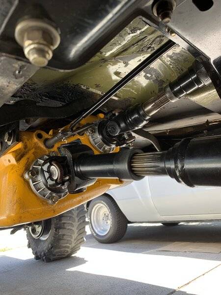

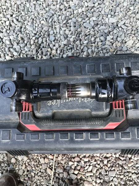

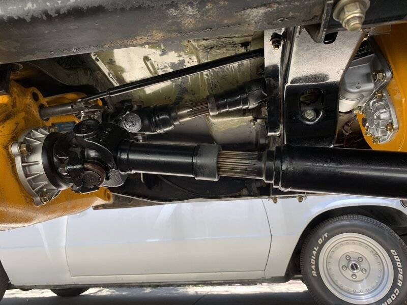

Got the intermediate shaft made. Expensive little bastard, it cost the same as the rear. LOL. Shop said the smaller parts are more scarce. I could actually drive it if I wanted. Leaks and all. Lol. Gotta make a rear brake line, and add fluid, bleed ‘em. Tighten up all the suspension. Gotta do a backyard alignment somehow. Still quite a few small things before the maiden voyage. Maybe in a week or so.

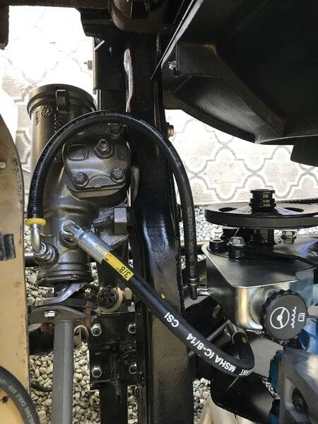

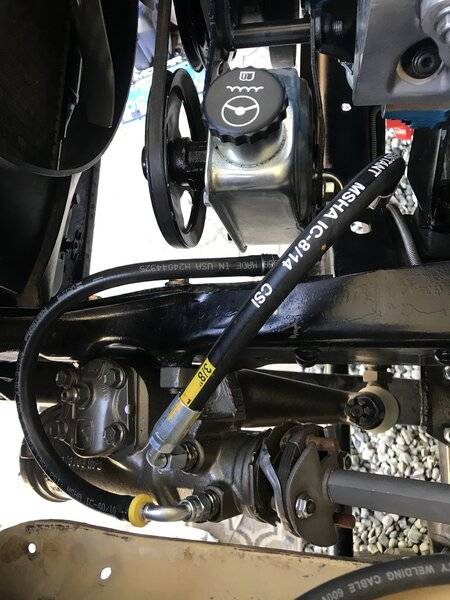

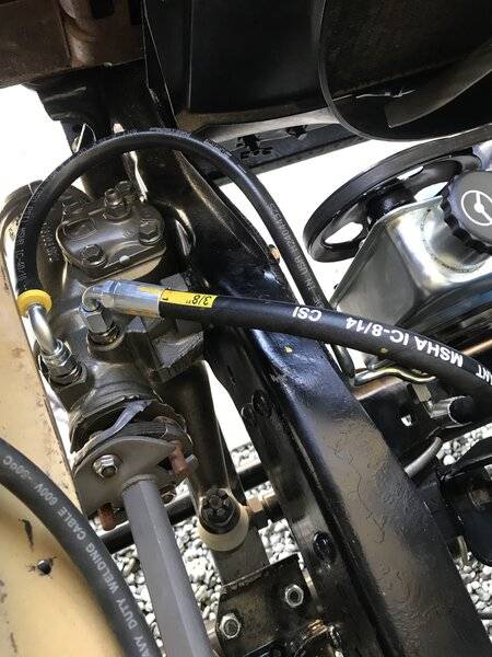

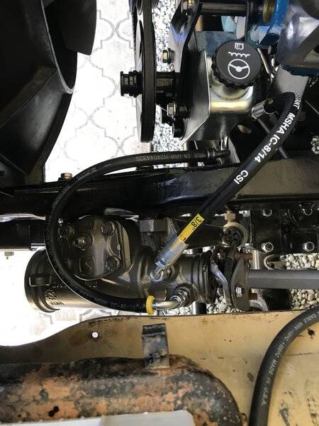

Well since I moved the steering box, and used a more modern pump, I had to make custom lines. So I had to adapt from the metric O-ring to 37 deg AN flare.

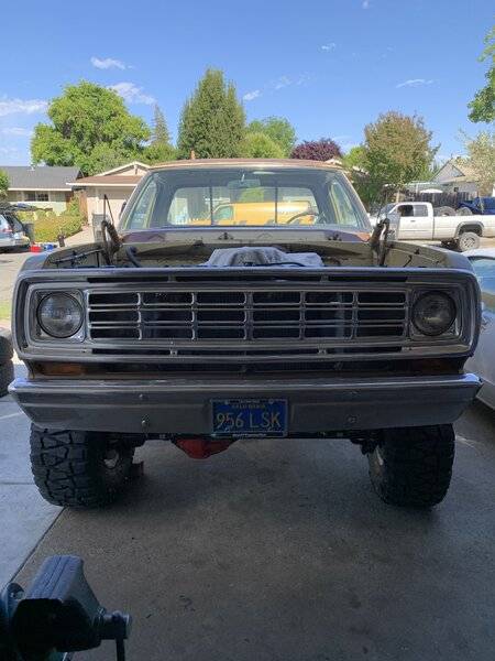

well today I pulled it out of its spot for the first time in months. I went down the mile long driveway and came back...there's quite a few things I have to address...
-the throttle is like a light switch, its on or off...You can't even ease into it...??? I definitely, absolutely need to get that fixed. I don't know what it could be. I have the dang thing hooked up just like any other mopar...
-those mud grapplers are all over the damn place, truck wanders pretty bad, I've read they're like a tractor tire, they do that...? granted I don't have shocks yet, that could contribute. I also did a back yard alignment the best I could, so that needs improvement. They are 35's....I think they're too big, there's a bit of a rub at full lock. I'm probably going to go down to 33's...
-the clutch...I installed a new clutch and pressure plate. It's a Mcleod Diaphragm. I took out a borg and beck...it feels like there is no pedal, like a hydraulic pedal on a honda civic. it seems to work, but there's really no feel to it at all... it's so light and there is no effort, I don't really like that. Is the difference between a borg&beck and diaphragm that severe??
-the brakes feel spongy...ya know how there's rust build up on the rotors and ya gotta wear that off? maybe that's what I gotta do. I probably have to bleed everything again now that the truck is moving and going through the motions...Those little plastic caps on my master cylinder leak like a sonofagon, maybe I have the reservoir filled too much...
-the Detroit Locker out back...I think I hate it. Although I've never had one before, It pops, it bangs, it makes a whole bunch of noise, and the truck kinda jerks...I guess that's what they do, but holy ****...LOL. it makes it difficult to diagnose and listen to other things when ya have that going on too.
-open headers is fun for a second, I really need some exhaust so I can hear what the truck is doing...But damn, it sounds good! lol
-I have to fix my manifold and rear main seal leak pronto. But I want to get all this other stuff sorted out first.

For everything wrong, it sure looks good...:thumbsup:...

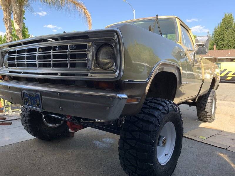

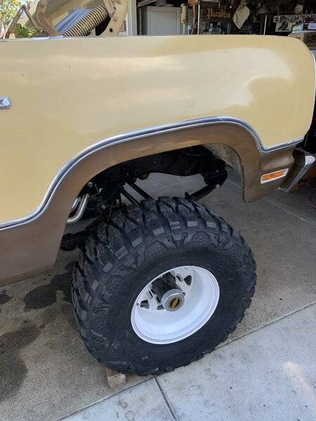

I’m going down to a 33/13.5/15 super swamper or Nitto Mud Grappler. A narrower 35” tire would probably work just fine, the ones I got are 16” wide! I found out and as most people on the truck pages say 16” wide is very wide and of course they’ll rub, go down to a 12 or 13” wide. Duh. Lol

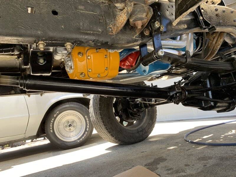

I need a front driveline before I can have the exhaust made, so that’s next. I’ll call the driveline shop tomorrow.

Got the front drive line back from South Bay Drivelines. I got the manifold all back on. No more leaks. Just gotta do the rear main seal.

View attachment 1715716406 View attachment 1715716407 View attachment 1715716408 Got the intermediate shaft made. Expensive little bastard, it cost the same as the rear. LOL. Shop said the smaller parts are more scarce. I could actually drive it if I wanted. Leaks and all. Lol. Gotta make a rear brake line, and add fluid, bleed ‘em. Tighten up all the suspension. Gotta do a backyard alignment somehow. Still quite a few small things before the maiden voyage. Maybe in a week or so.
That's a small shaft. I bet you hear that a lot. lol

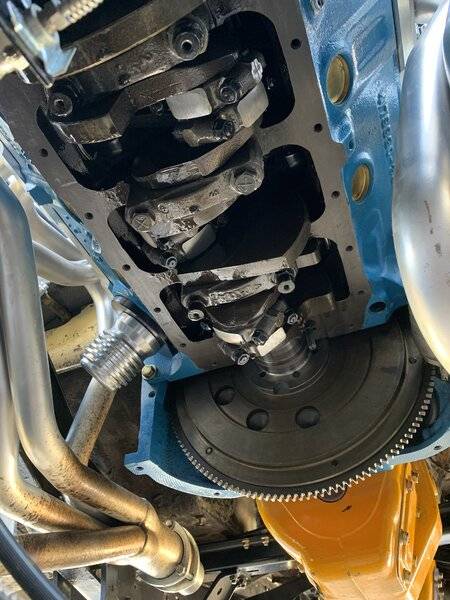

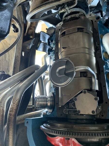

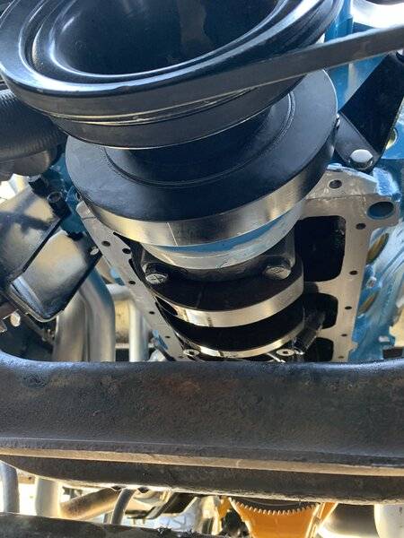

Well Hot Damn. I dropped the pan and did my rear main seal today... Took off the windage tray, oil pump main cap and loosened all the other main caps to drop that crank down just a touch. That trick seemed to work nicely. I tried first not doing it with no luck, didn’t wanna loosen the other mains but I did it and it worked great.
You can see the original seal, it’s tore up. Like it was installed with no lube, maybe it grabbed the crank and spun? there was a strip of rubber on the crank I had to scratch off with my fingernail.
Took me 9 damn hours today.
20 dollar part, 1,000 dollars labor. LOL
don’t know if it leaks or not, haven’t had a chance to put oil in it and fire it up. Got late.
