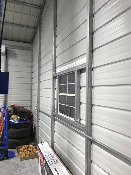

I had a metal shop put up a little over a year ago. Here it is about 58 degrees and raining. I’m noticing condensation inside (I figured I would, read about it some a while ago). I’ve always had the intention on insulating my shop, guess I should do it sooner rather than later.
As far as that is concerned, I’m not sure which insulation is the best/most cost effective. It’s your typical metal garage, with square tubing as the frame wrapped in panels of sheet metal.
I’ve read about using foam boards and sealing the ends with some kind of gap filling spray foam. When these buildings are sold, the company offers a type of “bubble wrap” insulation. I was told to stay clear if this.
I’ll most likely start with the roof and work my way down, with the goal of doing it as cheap (but effective) as possible.
Any recommendations on insulation material (and techniques for the job) would be greatly appreciated.

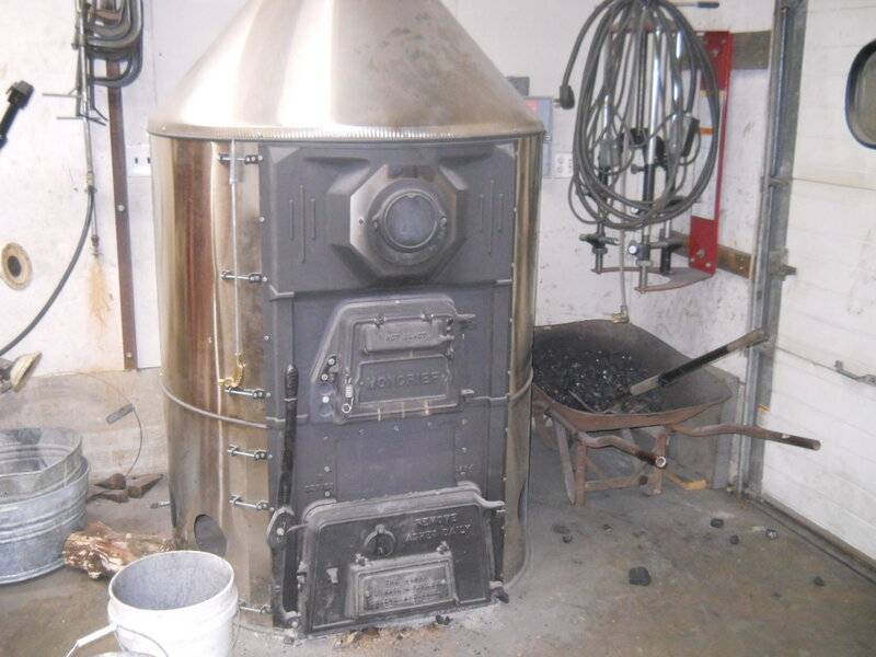

My shop is all wood construction and insulated. It still draws moisture because of a second floor and no ridge vent. Stay away from the foam its a fire hazard. Space heater with thermostat set at 40 or a coal stove. We had to do this or the machines sweat going from hot to cold. This barn was foam insulated. It went up in seconds and the owner a friend burned with it.
We have a coal / wood stove. 3 shovels every 12 hours. Keep the metal warm. Moisture is our enemy here
Terrible about the fire
Thats an impressive shop you’ve got, large stove too!
